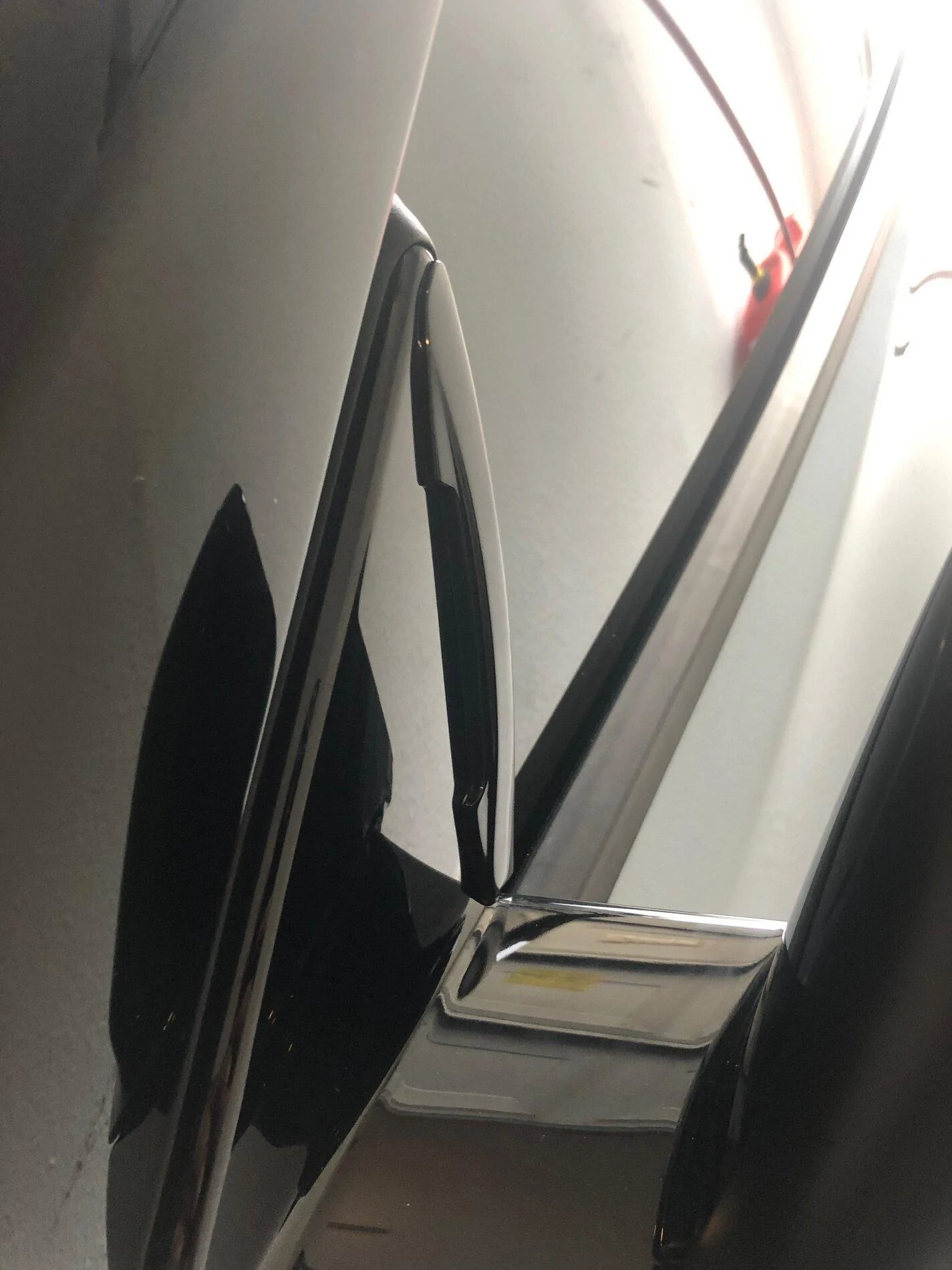

Can also confirm that the 2 on the bottom of the pack of 4 from the Amazon link were unlabeled / blank, and perfect for use... Only used a pair of snips / sidecutters to remove about 3/8" from the bottom. Drove around at about 65mph with no buffeting, only standard wind noise, couldn't be happier :headbang: Night and day difference for sure.
Thank you @tadda for posting the $9 Amazon link!!! :respect:
So glad I was able to fix this without paying the Supra tax on some of those options in the original post that are $100+...

Try to go 100+
...STILL NO WIND NOISE!! :headbang:
such a good solution for a couple of bucks haha
+1 for this solution. The wind buffeting comes in again but lightly (unlike stock) at like 70-80MPH. Any lower speeds and its completely gone.
Pack of 4 still comes with 2 with no branding. It looks like a stock piece, nobody notices it. Trimmed it a little bit with some medical scissors. Any cutting tool should work.
