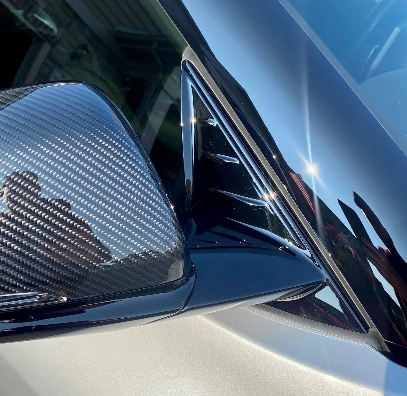

I see you have the gloss black - have yours maintained their integrity or has the clearcoat failed? Asking because the clear on mine failed after a couple of years
I had the AMS. Mine didn’t did hold up well. Passenger side clear coat started peeling off. Car was garage kept.

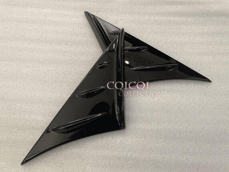

IMO these are the best ones for the money.
They look oem and work perfect at less than $80.
Link: (no affiliation with the seller)
https://www.ebay.com/itm/1848381645...ofBQKtXRxa&var=&widget_ver=artemis&media=COPY
Would you be able to explain to me how you installed these? I know it's straight forward, but I don't want to press glue and tape onto my brand new car without being absolutely sure of it. I just bought these, and they look great, and you can hardly tell it's an aftermarket part even up close. I'm also worried about water seeping in between it, have you noticed this happening?

Okay, thank you. I wasn't sure because mine came with a small thing of high strength glue.

Mine did as well, with no instructions. However, it seems that most people here used the glue as a (I guess) belt & suspenders attachment if the tape should fail. I just put on a small dab in the middle, and if I ever need/want to remove these things (I can't imagine why I would) it shouldn't be too difficult to pry it off.

Update: My eBay winglets performed well, no noticeable buffeting noise until I got the car over 110 MPH, and they are still on the car (using the supplied tape and glue) even though I might have seen speeds of 135 or so. Yes, I was on the track, nothing stupid on public roads.

I just received my eBay winglets. It came with double-sided adhesive and a little black tube of glue I'm assuming.
What was your installation procedure? Yes, also googling we speak.

I used the tape on the perimeter of the pieces, and put a dab of glue in the middle.
