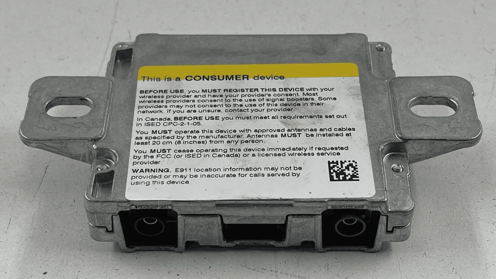

I don't think they actually put the "transmit" antenna in the unit. From the information I was able to dig up, the connection that OP disconnected was the connection to the external antenna...

Looks like the usual Fakra connector to me, however the fact that there's only one implies that either the amp and inside antenna are contained in the charging unit, or the amplifier is somewhere else and only the inside antenna is in the unit.
The amp appears to be mounted in the trunk near the subwoofer according to the service manual

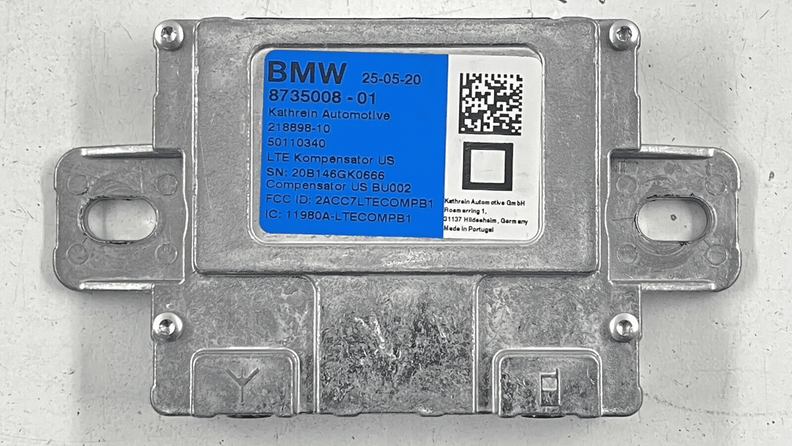

If correct, that's the thing you want to unplug. Cut power to that unit instead of just unplugging one of the antennas.
I just found one for sale on eBay and that's definitely the part. It looks like the center wire is for power and the other 2 are external/internal antennas
Yup. I see the German name is "LTE Kompensator" - it's in the English service manual as "LTE Compensator" if anyone's looking.

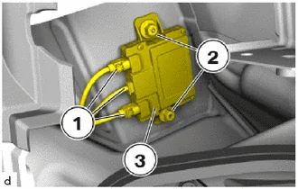

Here's a step-by-each from the service manual for removing the amplifier (aka cell booster, cell repeater, LTE Compensator)
Ignore the numbers on the following steps. They're taken from different parts of the manual, but are in the correct order:
