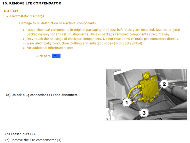

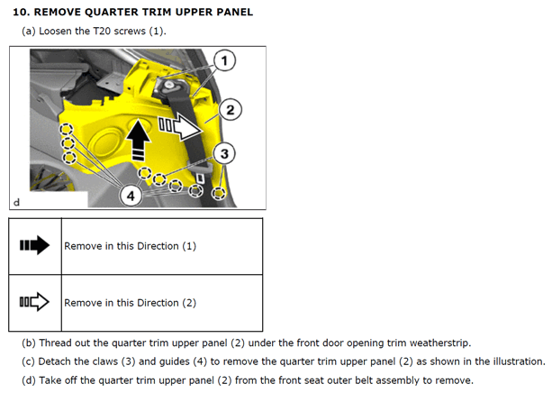

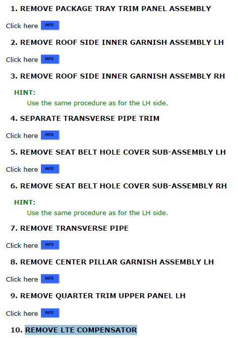

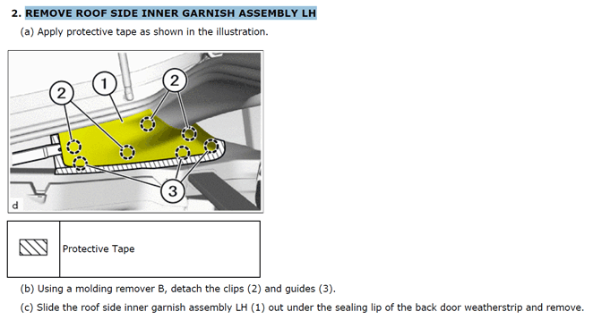

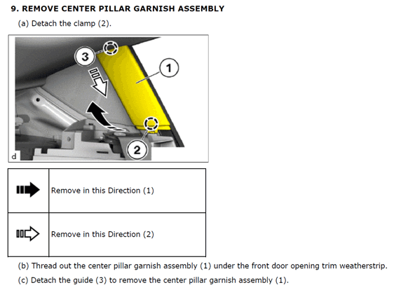

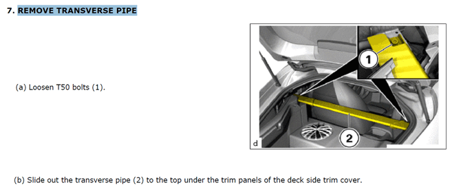

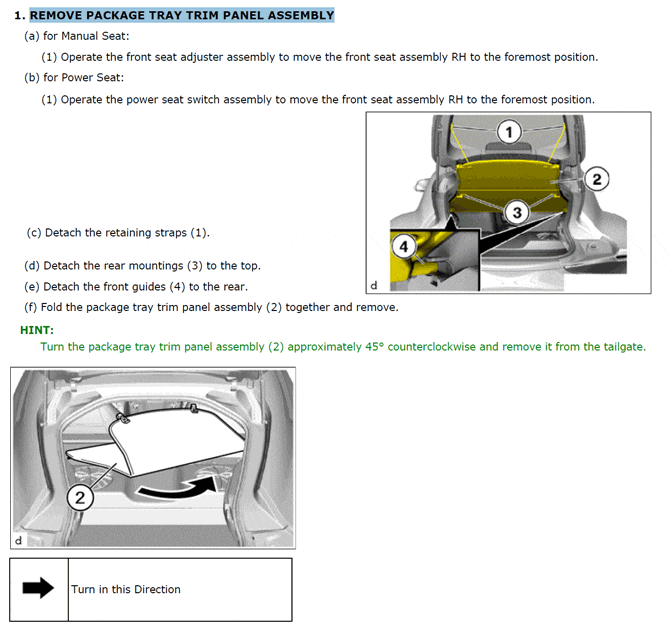

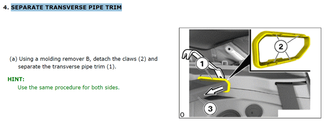

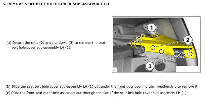

Here's a step-by-each from the service manual for removing the amplifier (aka cell booster, cell repeater, LTE Compensator)
Ignore the numbers on the following steps. They're taken from different parts of the manual, but are in the correct order:
I'm at a loss, I follow all the steps and the LTE compensator is nowhere to be found. Where is this diagram from????
I've wondered if all markets get them (your car being a Canadian one) since they have to deal with different regulators for cellular frequencies in different countries.
Post a pic of what's behind that panel.
