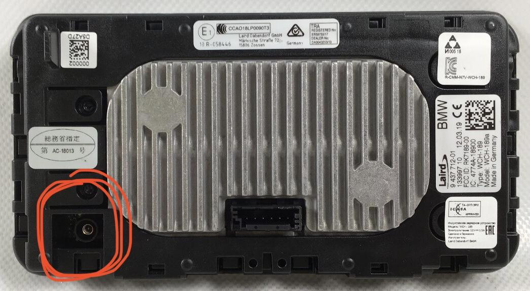

If you research more into the wireless charger, it's not just a charger. It has some significant telematics/other shit I don't understand in it. I can't for the life of me find the article that goes over it. It's from a German site, translated. So far I'm three days in, with multiple 45 min drives, and it's been charging, and hasn't turned my phone into a fucking 200Ā° brick like it did before.
I just removed the charger, and unplugged the telematics connection, but left the multiple wired connection in. Pic below. Do at your own risk, and I have no idea if this has any effect on any other part of the car.

Its a cell booster. Thats what causes the overheating. Being able to remove that part while leaving charging active is interesting, I may try this.
I really wish I could find that write up. It's pretty interesting. The charger has never charged fast, so that part doesn't bother me. I just like that it's not overheating

""Your car is equipped with a wireless charging tray (WCA) to charge your mobile phone and connect it to the mobile network. To ensure the best possible connection a signal booster (LTE-Compensator) is used in conjunction with the WCA.
You must not remove the booster from the car nor use it with any other than the preinstalled coupling device or antenna. Any modification of the existing antenna or coupling device as well as the use of other antennas or coupling devices will cause the cease of the boosterĀ“s operating license

Does the booster still work if wireless charging is disabled?
Yeah I've read that. I'm still looking for the write up that I saw regarding it being more than just a cell booster, but whatever.

From an FCC doc I found:
"Your car is equipped with Wireless Charging. To ensure the best possible connection between the Wireless Charging pocket and the vehicleā€™s antenna, a signal booster (i.e., Compensator) is used. This booster enhances only the cellular reception of a phone that is placed in the Wireless Charging pocket, not other phones that may be in the vehicle"
Funny enough I think they need to be registered with your carrier and nobody does that. I may have to crack out the old manual and see if it has anything about that in there.
If indeed we can remove one plug to disable the booster, while keeping the QI charging enabled, thats great news.

I wonder if the overheating issue form the booster is the phone constantly connecting to the booster (closest, strongest signal) to test if it works, failing, then going back to the regular cellular signal. Then doing that over and over.
Im still gonna unplug mine.
