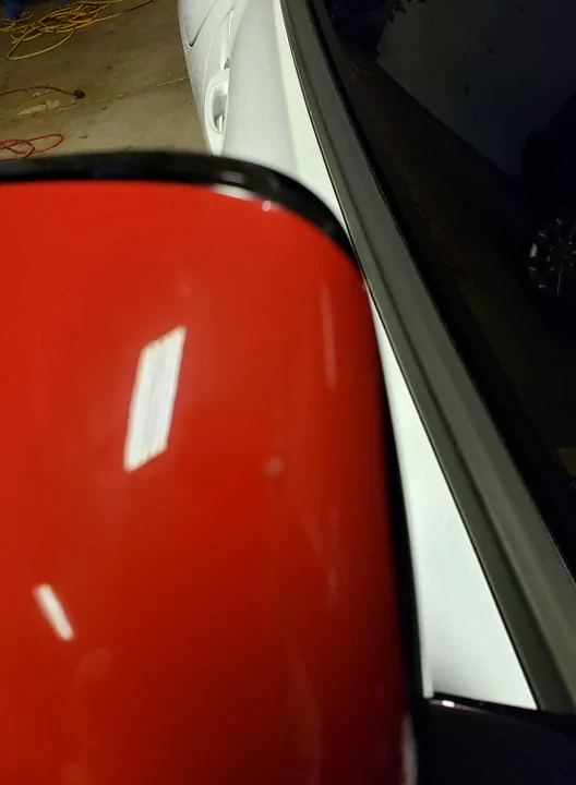

My mirror, line is pretty difficult to photograph...

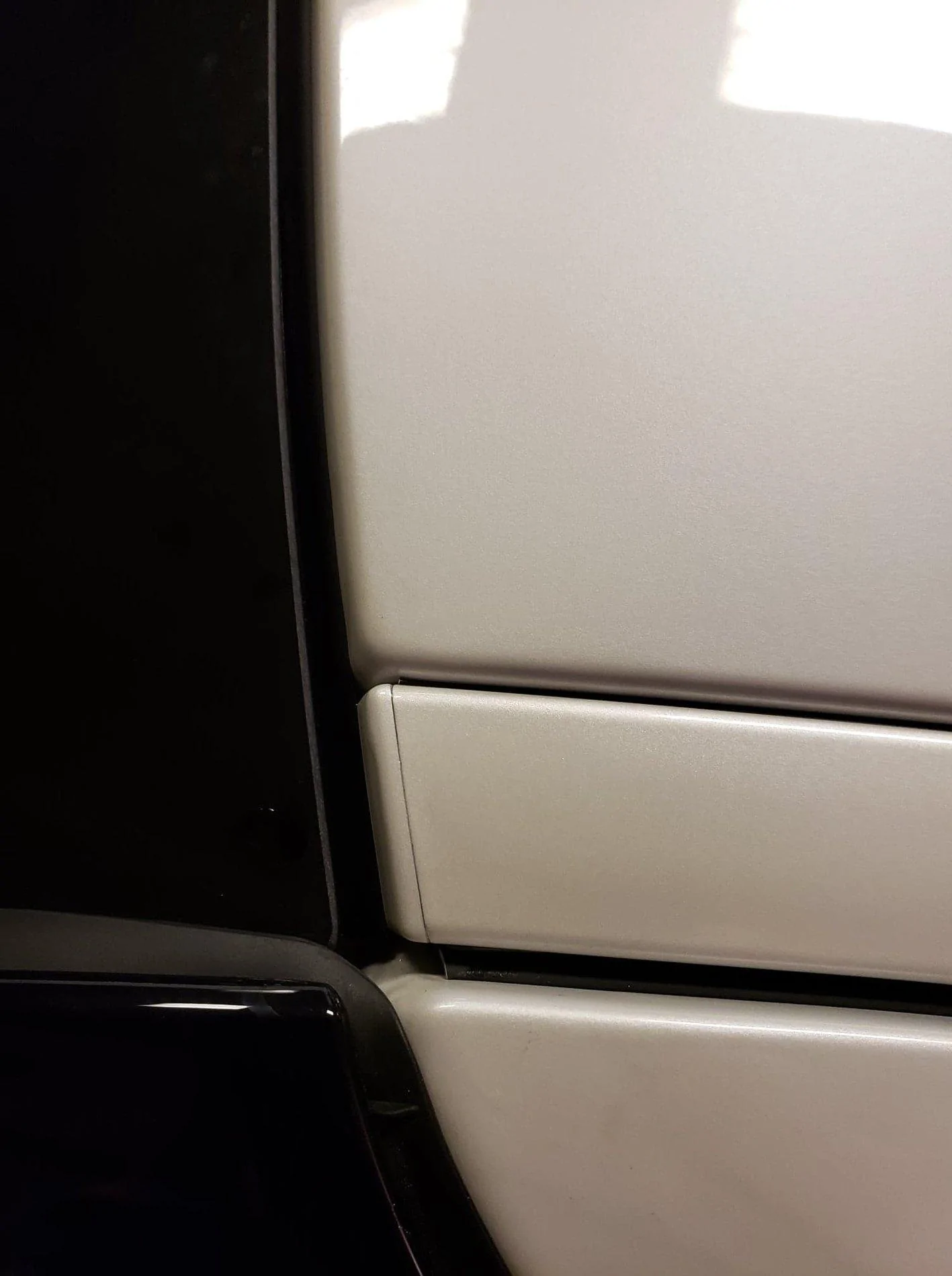

My hood is wrapped, but that thing on the left isnā€™t, I donā€™t believe anyway, I think that is from the factory.
Here is the front of my hood to the bumper:
Hard to see, but this is at the top of my hood, they said the sheet wasnā€™t long enough but they were able to stretch it and align it with the crease. Unless you are looking for it, it is hard to see.
Template was not used for any of mine.
