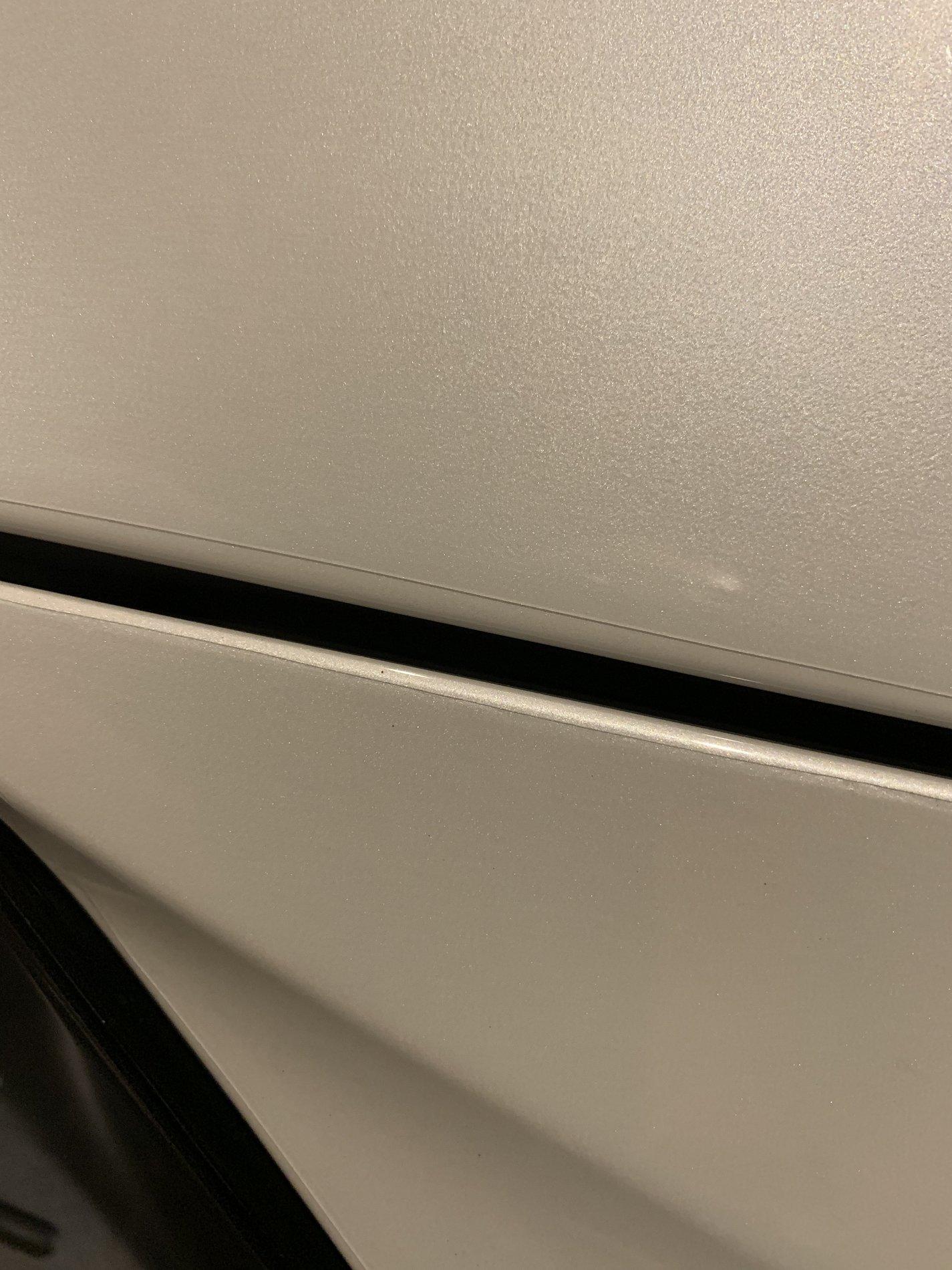

Front bumper - why in the world is there a giant V in the pre-cut piece? You can see it's already getting dirty.

Note I do need to wash the car as I was caught in a rainstorm and I haven't tried scrubbing that yet, I'm worried what might happen. Want to show the shop first.

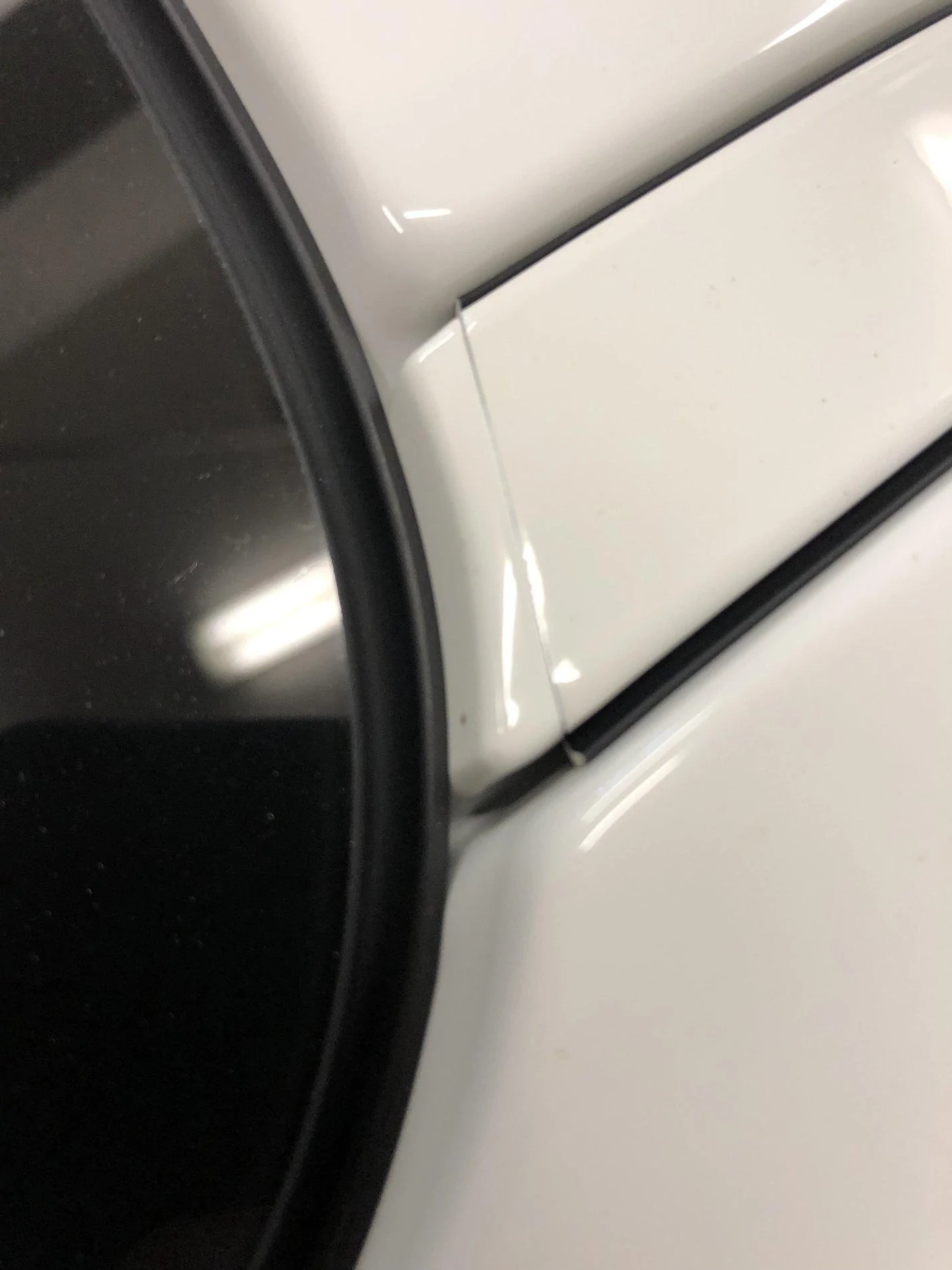

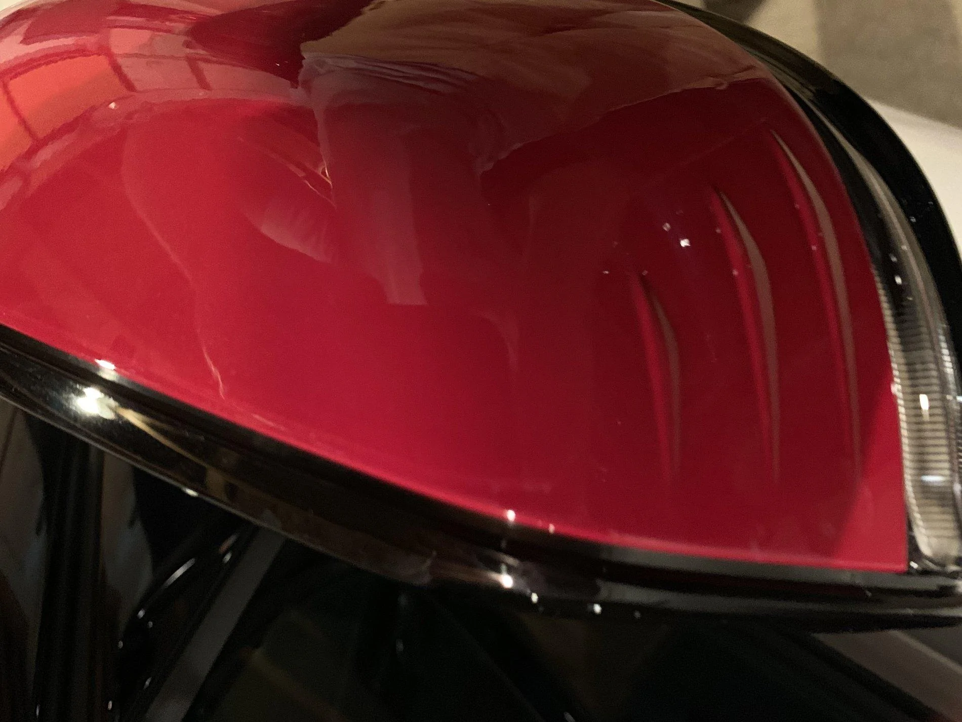

Yes. Here’s a pic of the gutter cover on my M2 Comp, with no PPF installed. Supra is the same style part.
AH! Thanks! That makes me feel a little better. lol

hey I updated my previous post with my Supra roof picture. no wrap. just to make you feel even better :)

That may be normal for their kit because it's a major challenge to fit areas like that. Whether or not a custom install would attempt to stretch there I can't say, but it would be a major CHORE. I have fought those before. So that is likely why the template kit has a seam there.
Visible seams and dirt are typical on a light colored car. I minimized PPF on my white M2 Comp because of this.

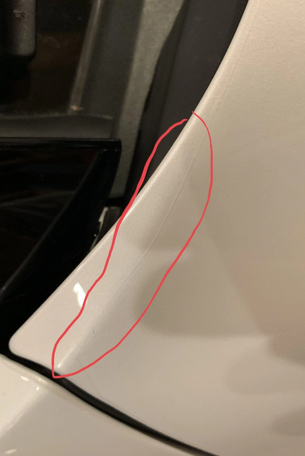

My mirror, line is pretty difficult to photograph...
My hood is wrapped, but that thing on the left isn’t, I don’t believe anyway, I think that is from the factory.

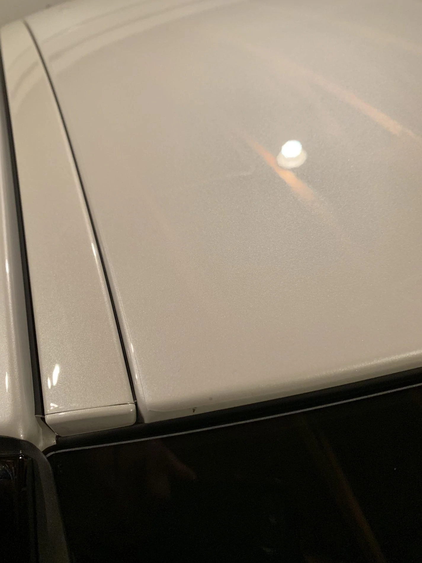

Here is the front of my hood to the bumper:
Hard to see, but this is at the top of my hood, they said the sheet wasn’t long enough but they were able to stretch it and align it with the crease. Unless you are looking for it, it is hard to see.
Template was not used for any of mine.

I believe my installer can do better. He custom cuts the pieces on the car and he wraps the edges where he can get access. The small-angle corners are very difficult to cover, but uncovered edges in the photos can be significantly reduced. The seam on the mirror cap lifted, it was probably improperly sealed.

Mirrors have a limitation at how far a film can wrap over the inside bend. The bottom and even some cars mirrors top. Film is slightly stretched over and if done custom put on further then precut. Because people always ask can you go as far as you can. Generally you go to its limit but sometimes a bit more. That mirror is fine, they just have to trim the lifting part off and heat it.
Warranty - is not void from XPEL or anyone else if the edges are wrapped. The software gives you an option to wrap the edge but you get a V shaped corner like you have. That is because it is a precut piece. To do it without the V edges it's a custom by hand install where most shops won't because they have to know how to use a blade.
Bumper precut from seeing the kit is 11 pieces total. Film has limitations on going over bends and curves like the Supras. You aren't the only one with those seams believe me, there are plenty others and many more will be.

I'm sorry to say, but that's not a top-notch installation. The areas with a high probability of chipping are left uncovered; hood edges and accessible bumper edges should be folded.
