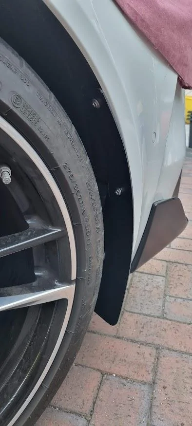

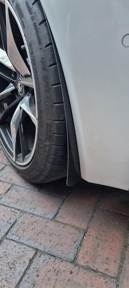

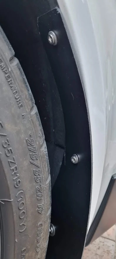

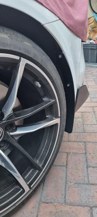

Just need to find the right length socket-head hardware now as I've used screws and a few washers- but here is my first prototype.
Works well - it uses different length nylon spacers to orientate the correct fitment and the great thing about these flaps (ooer) is that I have drilled slots so you can move the guard more outwards or inwards depending if you are running wheel spacers.
The plastic would be ideal cleaned up a bit as its not stamped/laser cut as I simply it out with a Stanley knife.
Fronts next (easy)

great start ... obviously black 8mm bolts and washers would tidy it up.
i think to bottom edge on yours is better than the ZL1 !!

Hardware is a pain as M10 1.25" length socket head self tappers are proving hard to find....
