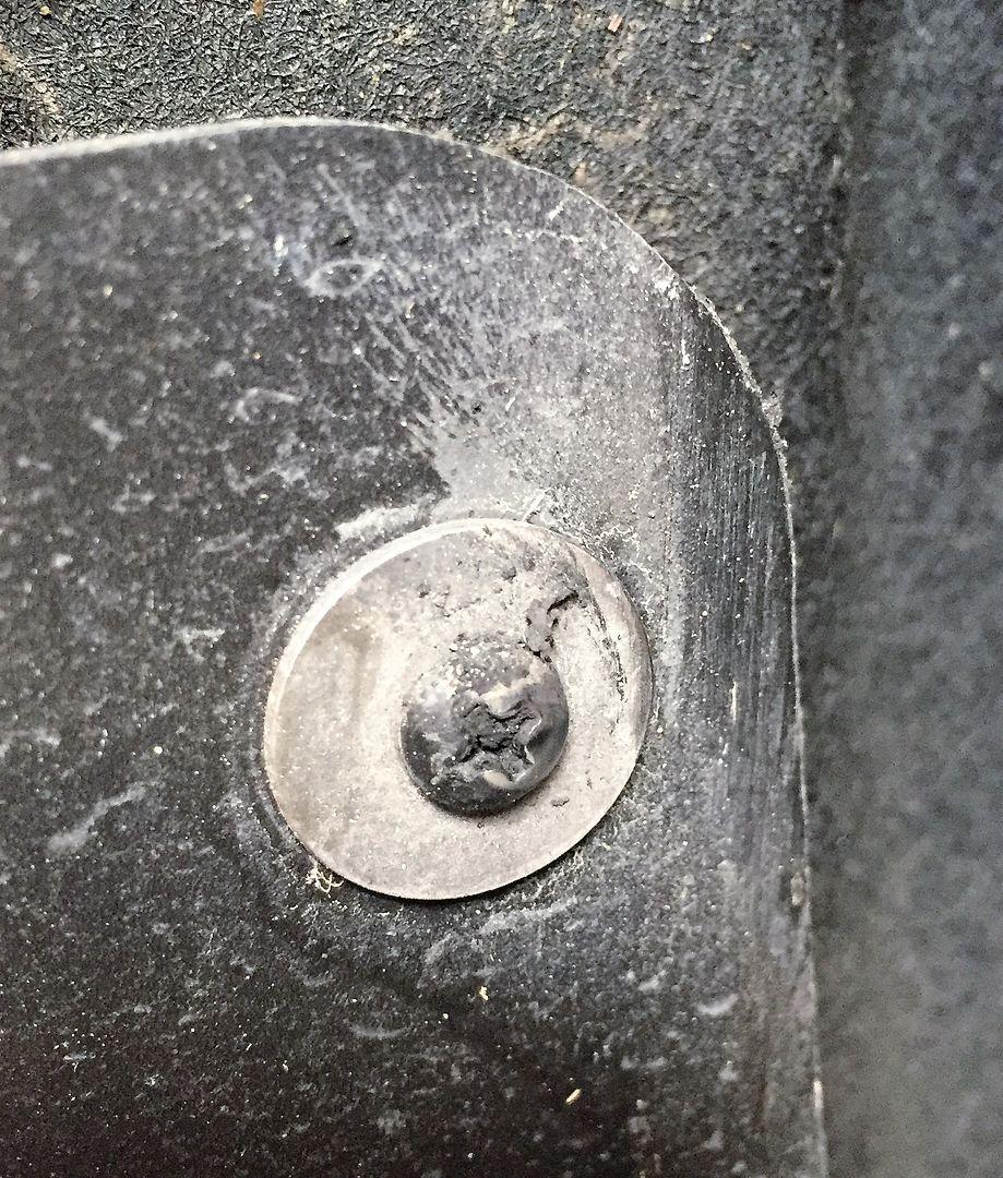

I have just come back from a 600 mile round trip for my daughters 21st party
My partner & I had the Supra loaded up a bit not to bad though
I'm on H&R springs with a decent rear alignment with around 2 degrees negative camber with 285-30 x 20 on 10.5" rims
They have pretty decent offset & the rim just sits inside the guard, just
If you have every been on our roads here they are like your canyon roads except a little narrower & rougher from what I've on in car footage
I had a rub on the drivers rear wheel in dips when the suspension loaded up over bridges & hollows etc
Couldn't see it when I was down there so pulled a wheel when I got home
Turns out it was rubbing on the top screw somehow, so I removed the SS washer I put on to give it a little more clearance
It wasn't a bad rub just annoying o_O

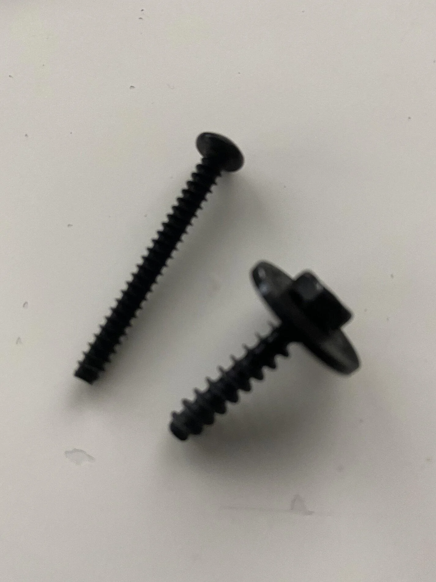

As reported rear wheel guards ship with No 8 or M4 screws - they never really grip...see pic below. Fat ones came out, skinny ones are what ZL1 supplies.
Picked up No 10 1.5" in black from Ace Car Supply (my guess is they use M5 proprietary trim screws but I couldn't find any). No 12 too big. No. 10 perfect size. 43 cents each. YMMV.
