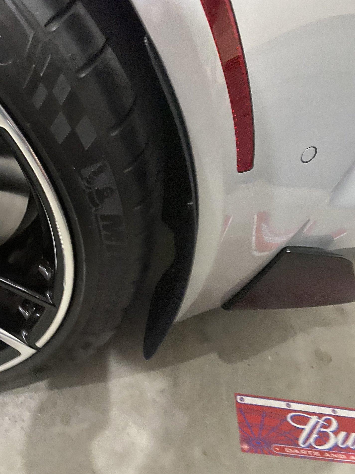

As stated above it’s strange some are having issues and others are not. Like I said I didn’t have to cut my rears.
it looks like there is a gap at the top half but there is not one. It’s flush to the fender. It’s just the camera angle.

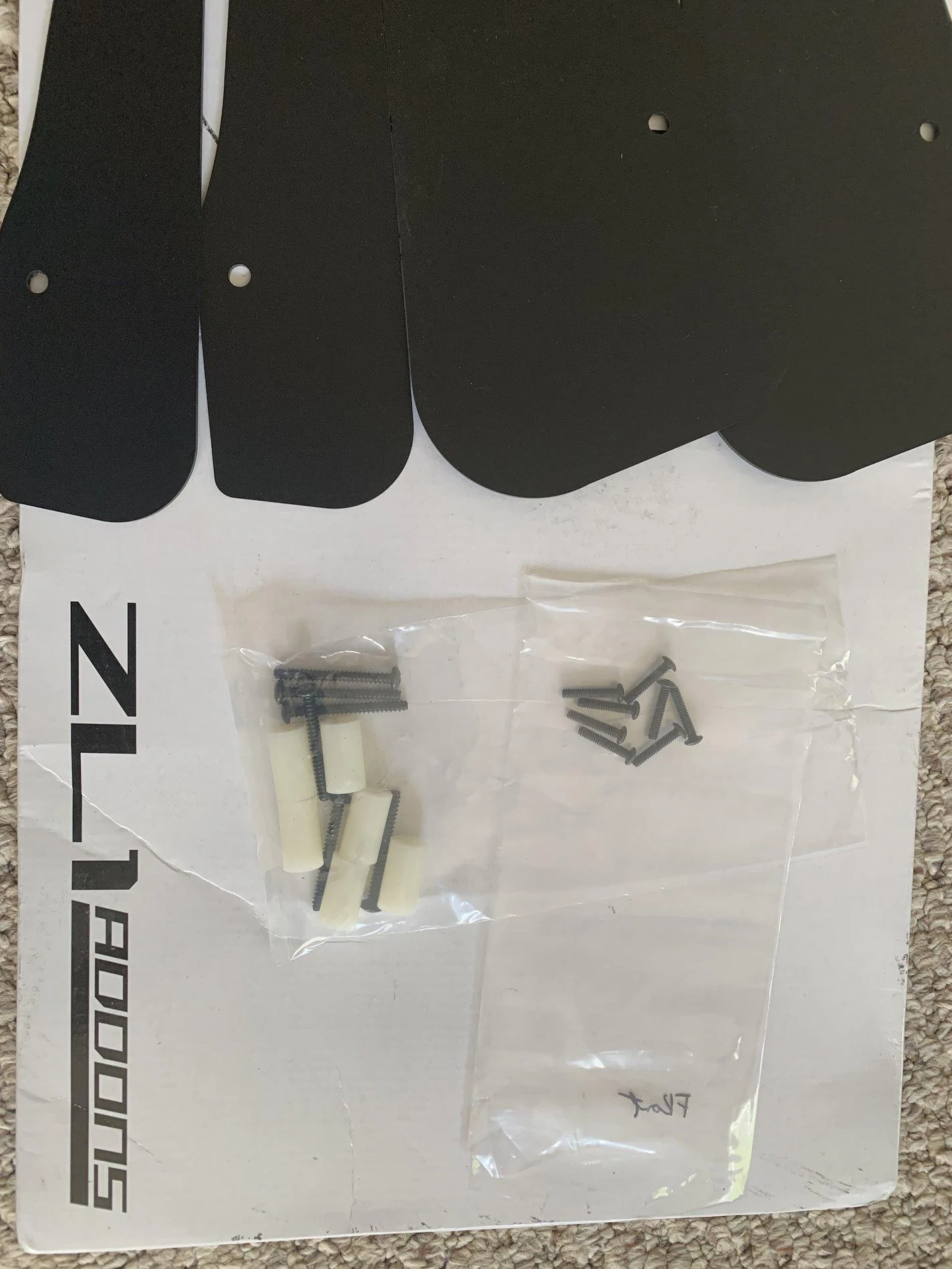

After waiting three weeks this is what I got
Can someone confirm is it correct?

Yeah, I felt the same way as you when I first opened it. Looks like the same package that I received, except I do see a problem with the bag labeled front. You should have some plastic pop rivets instead of the screws that you have pictured.
I would recommend finding some flat black washers to reinforce the rear screws. I also had to trim one of the white standoffs at the very bottom because it was too tall. Others stated that they didn't have any fitment issues. Be sure you tuck the front one behind the fender liner to give it support

NO!! That isn’t correct, you should have received “push rivets” for the front install!! You can’t reuse the push rivets because they don’t have enough “grab” to fasten the additional 1.8 mm of thickness—-this is exactly what I was complaining about!! There is ZERO quality control at this place—-looks like you just received new “pins” to stick into the old rivets—-and on the rears, find some black washers or better yet a hex head bolt so you can easily attach the rears—-using a right angle screwdriver is a PITA—-and pulling the wheels for something this silly is annoying when there were easy options for an ez install. Lastly, hopefully you won’t need to cut down the bottom most rear spacer to get the guard to “suck up” to the wheel well—-I had to do that too!!!! BUT they do look cool as hell when you finally get them on!!

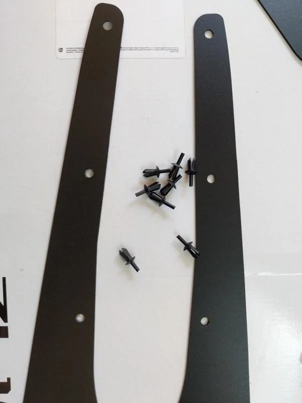

You won't be able to use the screws that they supplied. There is nothing there for the screws to go into. You will need to go to the dealer and pick up a few or order them online. The pop rivets for the front install should look like this.

Thanks for all your help everyone - what a pain - how does a company like this stay in business!:crazy:
I work in aerospace machining and if we screw up airplanes will fall out of the sky!!
I'm going to see if I can get the push rivets from Toyota or BMW dealership.

Lastly—-make SURE you push the center pins ALL the way out (you’ll hear them fall out) before you try to pry the rivet out—-find a small drill bit and push that pin all tbe way through
