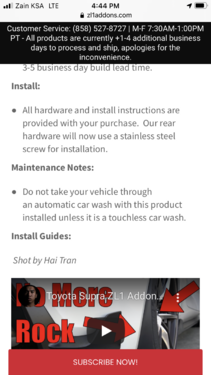

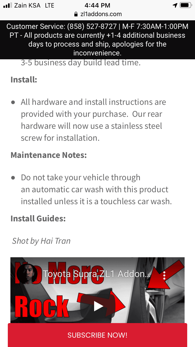

FYI it looks like they are now offering stainless screws for the rear. I’m going to email and ask if they are now using #10 screws instead of #8

I am confused, i thought they are sending it with the right hardware now but the post would suggest that they are not. Did OP get old stock or is this still an issue?

ZL1 got back to me, and the screws they are currently shipping out are stainless #10s. Looks like they've corrected the problem.
