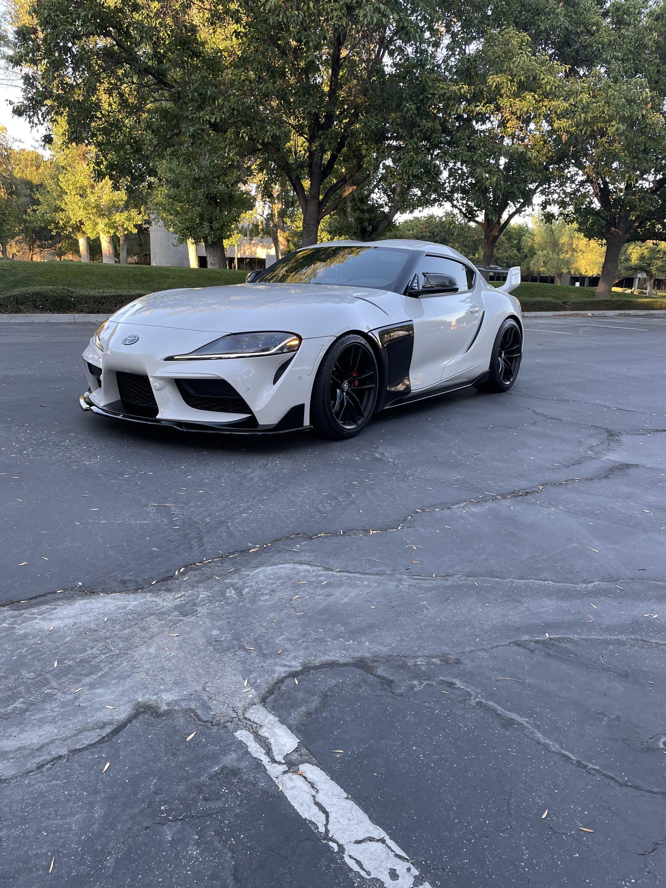

I'm considering H&R but want to go bigger on tire but also give it a aggressive look. Just not show slammed or anything I think it looks weird. Have you tried other springs?
love my h&r springs. Best look without being on the floor and rubbing.
This is on stock tires
