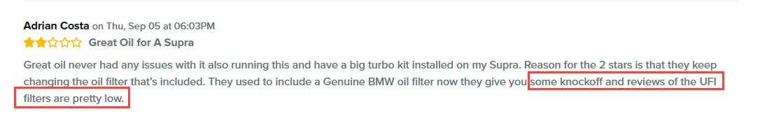

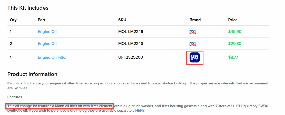

If anyone knows the best place to buy QuickJacks please do let me know as I also ordered the oil kit from FCP EURO to do it myself.
(https://www.fcpeuro.com/products/bm...MV4jjUAR1jmQIOEAQYASABEgJhjPD_BwE#description)
Honestly gonna switch the downpipe and exhaust myself at this rate if I just buy the QuickJacks.

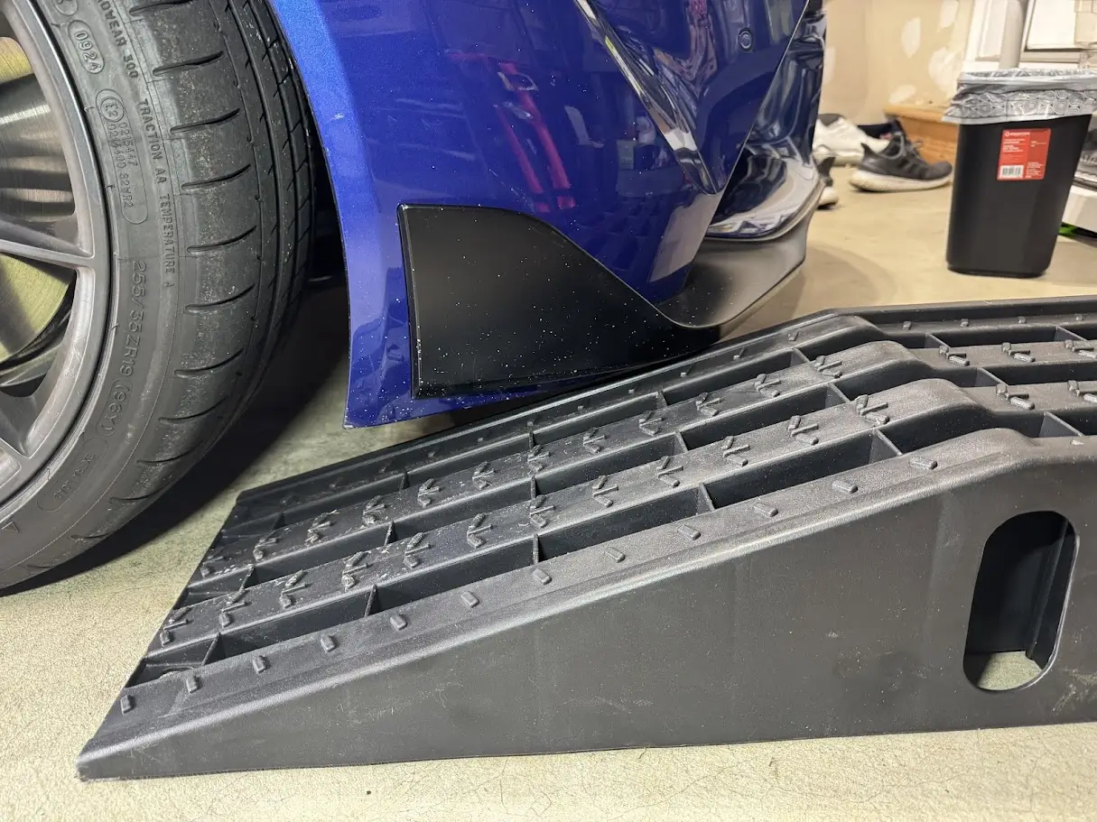

I'm curious, is the clearance ever a bother for the supra? I do have a 1999 jeep wrangler I've been working on 👀
I’m lowered (.8 inch) and have to drive the fronts onto a 1x4 for clearance. Rears clear. On factory height they clear with no issues.

If you’re at stock height, Race Ramps would work for changing oil. I got a used set off Facebook so I could install a high flow cat. At stock height, my car clears by a few mm. If it was lowered, I’d need the longer and more expensive 2 piece set.

+1 for Quickjacks. I use a floor jack to put my front tires on scrap wood for clearance on MSS lowering springs. The HF ramps would not work for clearance. I also tried the Race Ramps wheel cribs but it was such a pain to get the car up 12 inches, I gave up lol.
