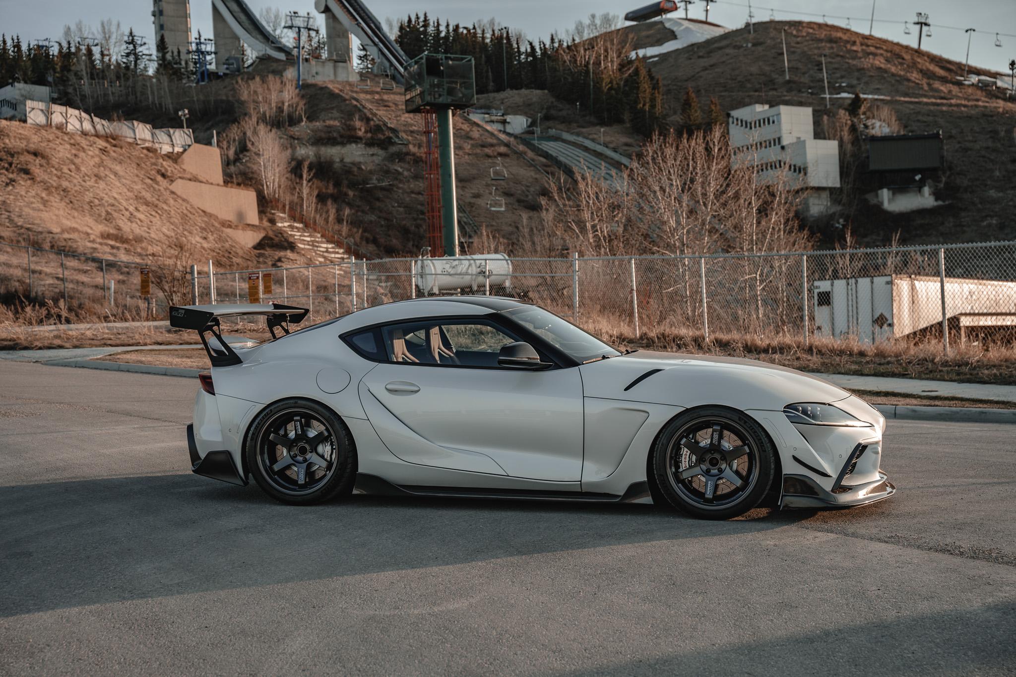

As I worked closely with Jeremy on the Signature Kit development for the Supra. Are the rotors from China? Probably, is it an issue? More time to tell, mines mostly street driven but Mike from Boss Boss Racing has the kit as well and has tracked many times and it's performed wonderfully.
Refurb or even brand new CTSV-V/ZL1 Calipers are dirt cheap. im talking they sell here in Canada for $450 CAD on amazon for 1 front caliper... Combine that with cost of CNC'ing the calipers, brackets, lines, pads, rotors the kits aren't far off from a "cost to manufacture/piece together" then to sell as a kit.

Damn that looks ? ?
