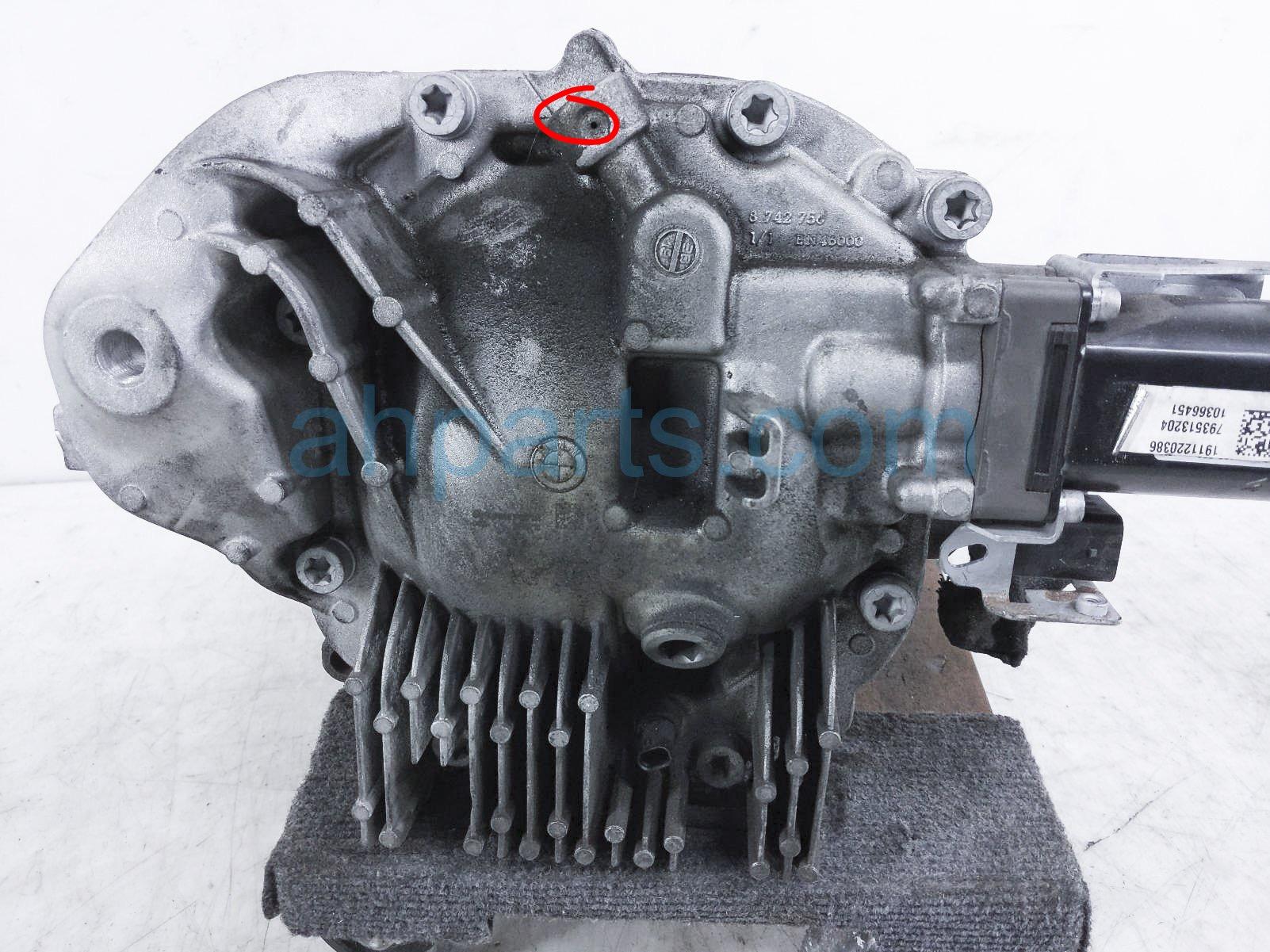

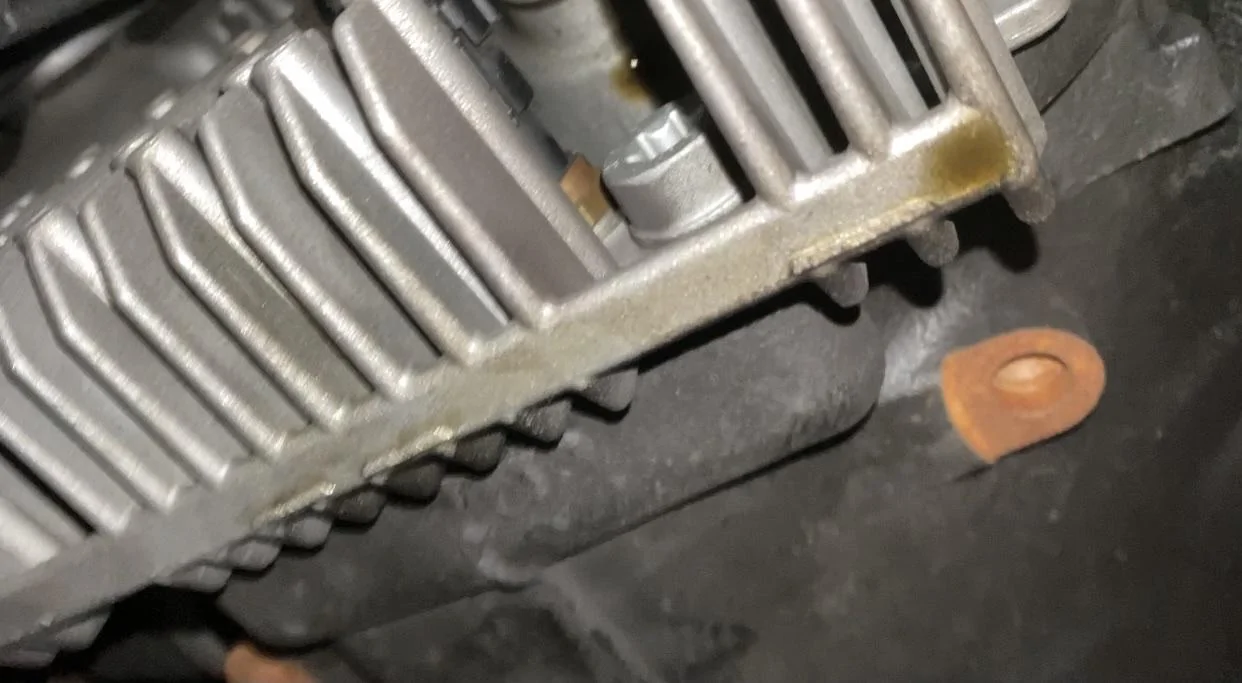

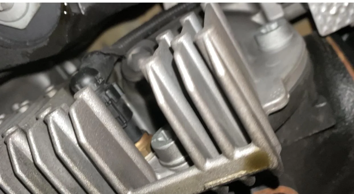

Hate to be a plunger and bring old shit up, but i noticed a slight leak on my cooling fins, drain plug and rear mount thingy....
would this pin hole be where the fluid spews from..? I've been looking at photos of the differential and i can't find anything remotely similar to a breather, the closest thing i can think of as a little "pressure relief" is this pin hole...

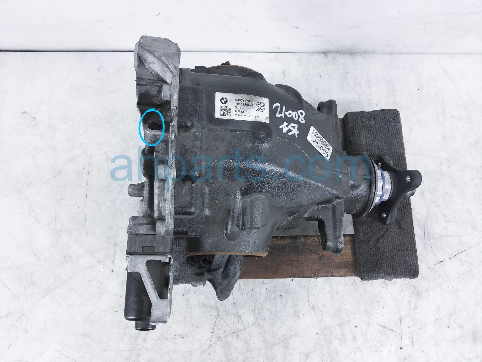

or this circled in blue...
