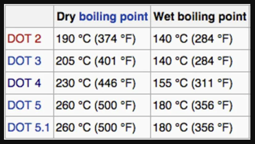

true in some sense. whilst you should not use DOT 3, you also should not use DOT 5 (with higher boiling point) so that's not exact reason you should change your brake fluid. there are other factors making up what is DOT 3, 4, 5, or 5.1. It is somewhat complicated. for a good reference, see wiki below.
https://en.wikipedia.org/wiki/Brake_fluid
and then, although that article is good in general, it is not entirely true for our car either. sorry to confuse you even more..
simplest way to put it is,
- change brake fluid more often because DOT 4, GR Supra uses, is hydrophilic - attracts water molecules - than other type. In other word, fluid gets stale faster.
- Hence it is better to change fluid often (like annually or bi-annually) regardless of mileage.
- If you want higher boiling point for track/performance use, you should try to find one within DOT 4 specification. And change it more often than Annually.
30
3,398
3,374

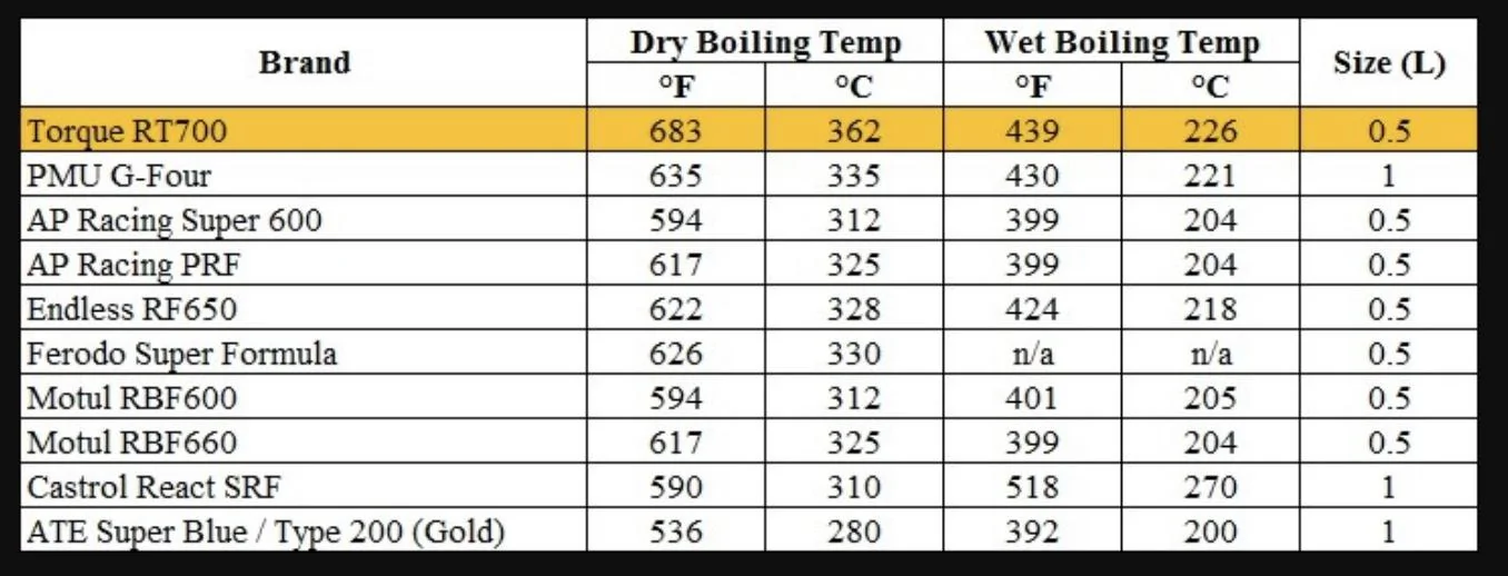

If tracking nibble is absolutely right. Preferably bleeding the fluid after each track weekend. There are huge variations between fluid boiling points, dry and wet for even DOT4 fluids:
Then there are industry standards (minimums):
They can vary quite a bit from industry standards. So even at my “wet” boiling point for say Castrol SRF is at 518F, I’m in no hurry to change (or flush) the entire system. But I will bleed out the dirty fluid. You’ll be able to see the difference with clear tubing when you bleed it. Once you see clear fluid while bleeding it, you’re done.
On my wife’s GTI that we don’t track, I won‘t be flushing the entire system at all. I’ll just add more over time when it gets low. Her car will never be under repeated “threshold“ braking with our daily driving. Thus we’ll never come close to our boiling points. Would it hurt to change it, of course not. Do you need to? Depends on your use and driving conditions.
