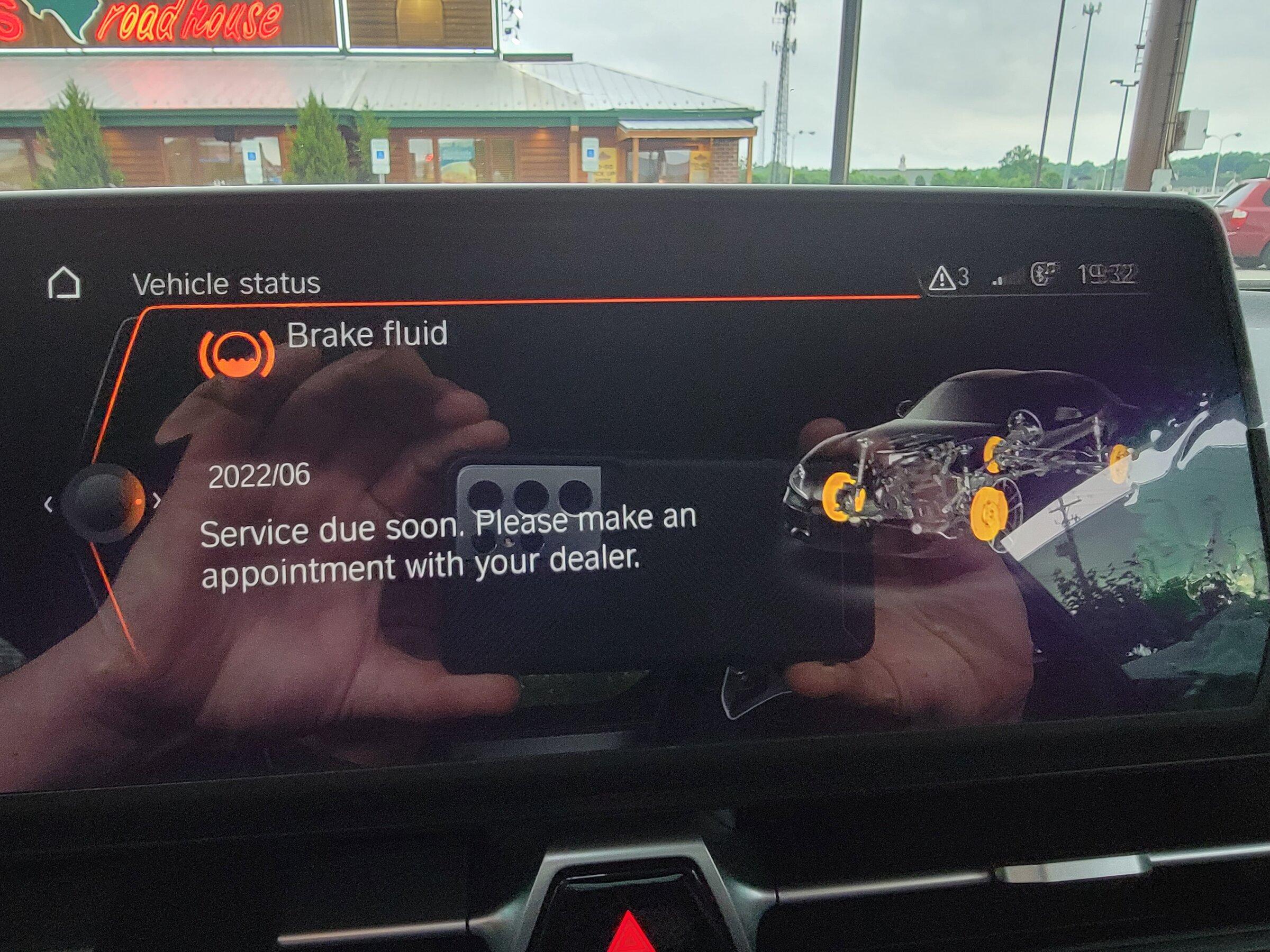

Hello, hope all are well. Does anyone have any idea why I would have this message? Car has little under 11k miles. Little back story, put drag radials on last week. Last Friday at the track, after a couple of burnouts, I noticed brakes were NOT working as good as they had in the past. They work fine at lower speeds, but when pushing the car, the peddle now feels stiffer and braking distance is increased.
Also, was gonna run out my flex fuel and just load 93 octane map to take to dealership. The brake recall is required in PA because it is a safety issue. So was gonna have both issues looked at. My car is 2020 and ECU was never locked. If I get locked out of it, with just DP, will car run fine till I have ECU unlocked?
I got mine while I was only at 16k but my dealer just reset it since the car was far from needing a brake fluid service.
