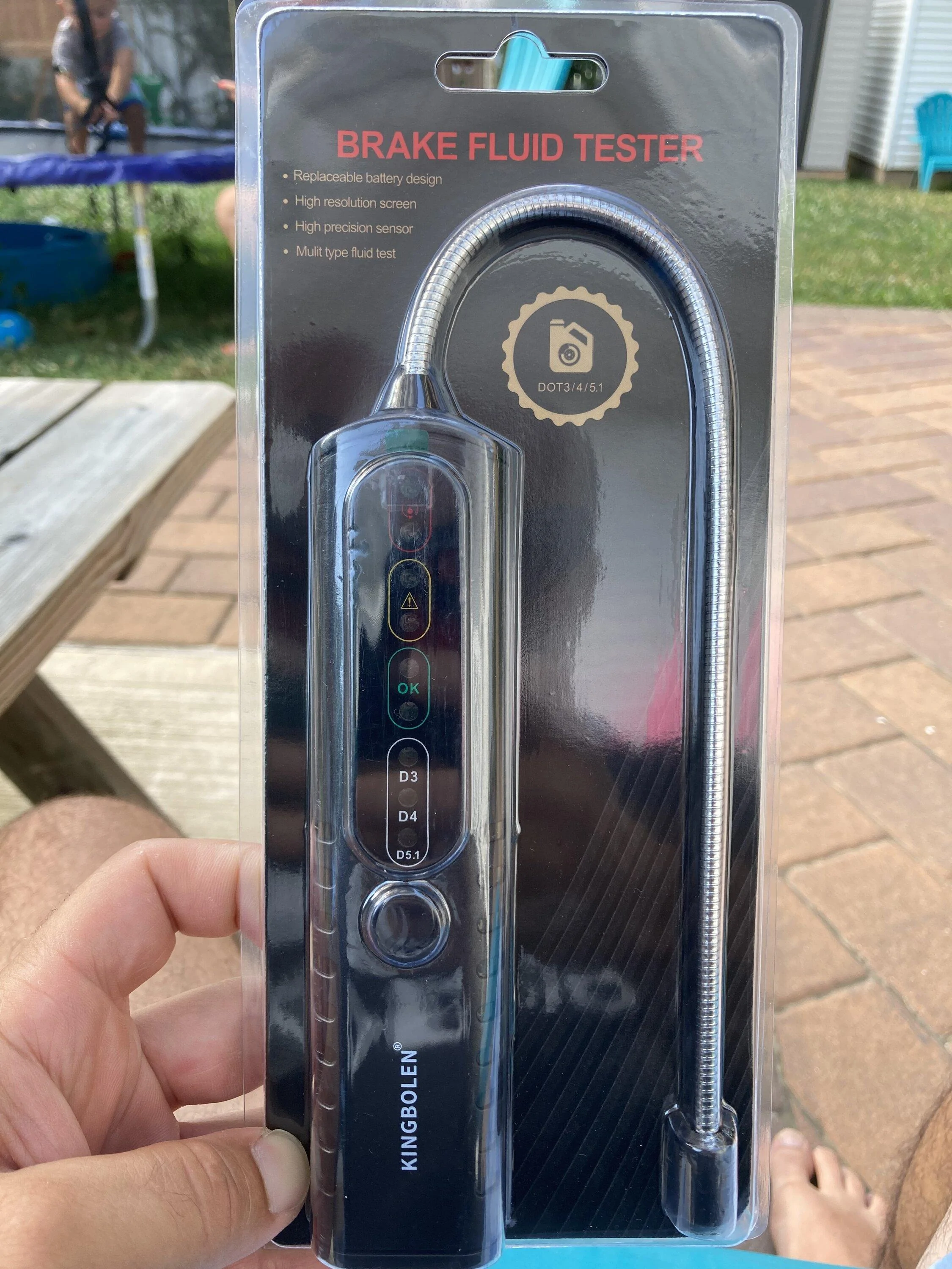

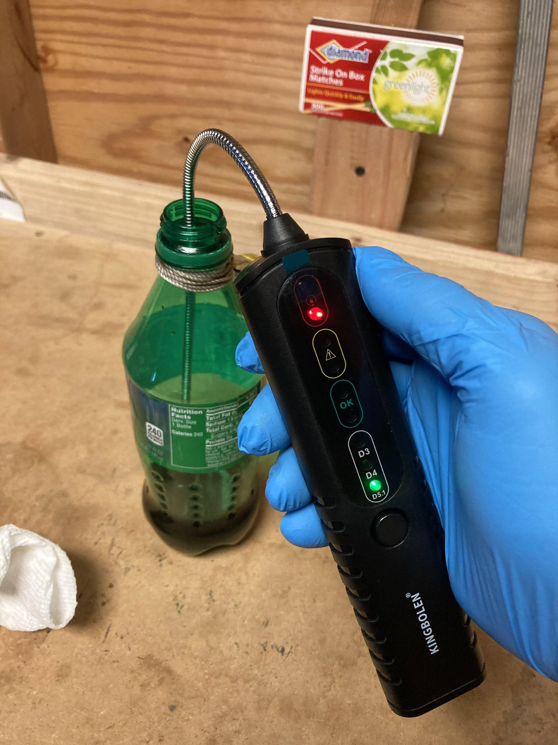

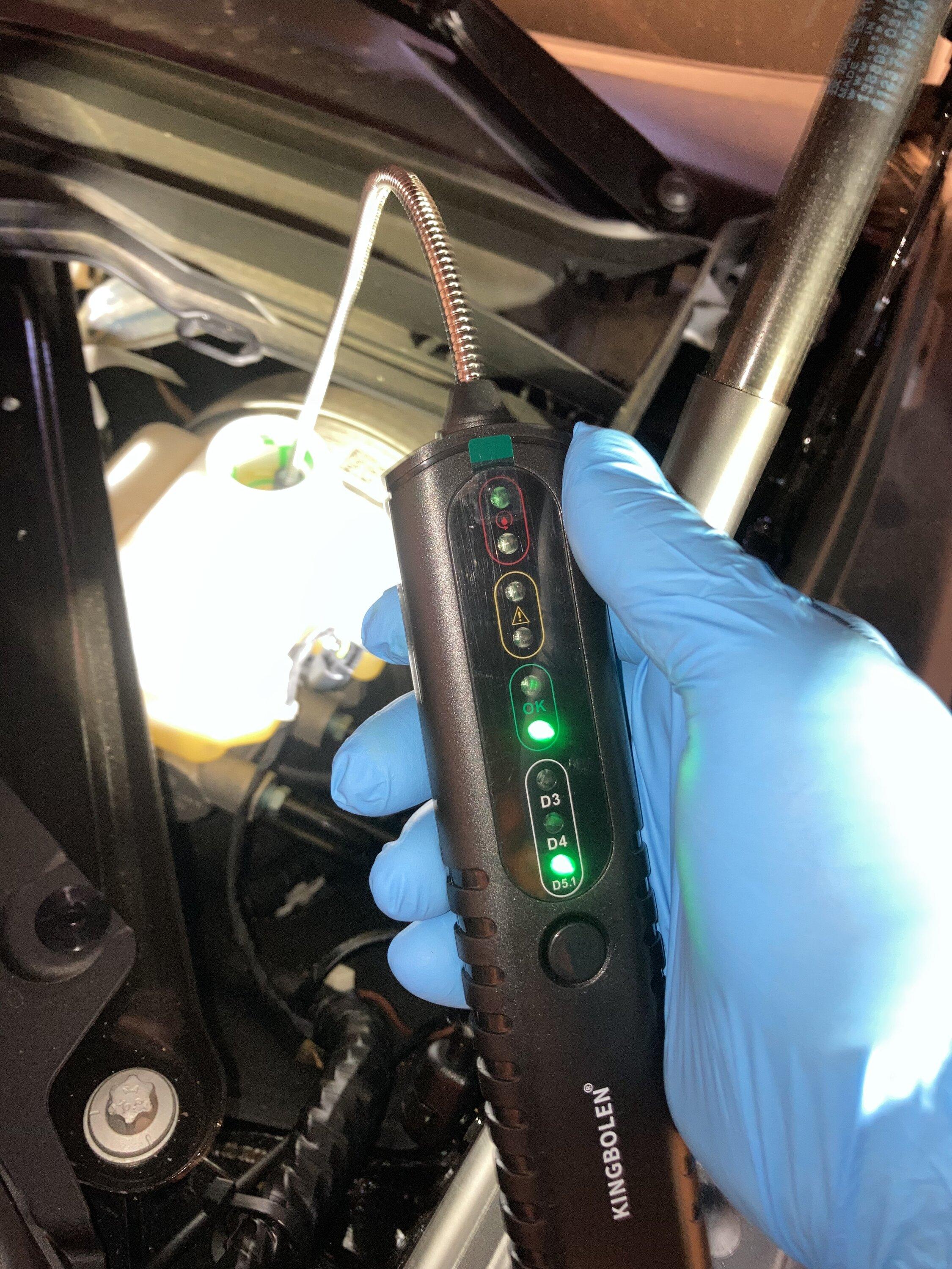

I went ahead and ordered a brake fluid tester on amazon for less than $20 Here. I threw some batteries in it and went out to the garage. I had some old crappy brake fluid from a previous fluid change on another vehicle, so I tested the tester and it seemed to be accurate with the old fluid. I then stuck it in the Supra reservoir and the tester showed the fluid had no traces of water. I will forego the fluid change for another year and test it the next time I do an oil change. Again, this was a 2020 with 9,100 miles used primarily in spring, summer, and fall in NYC.
