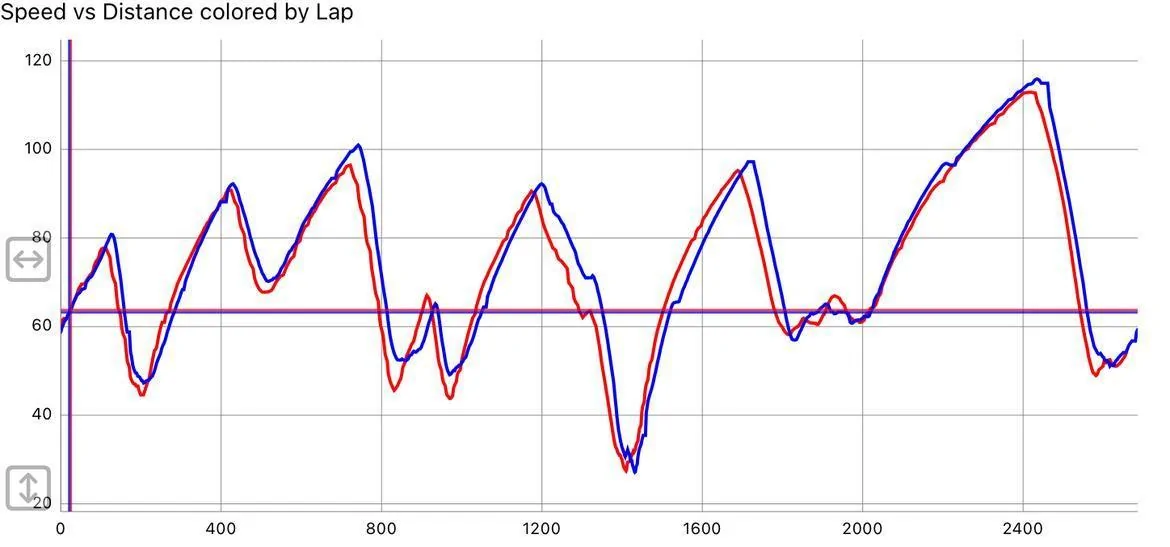

You're leaving out the part where, in the comments, they also mention that track conditions and weather had a lot to do with the manual transmissions time being so close.
When they posted the data log, the automatic was faster everywhere except for in braking zones in which both cars were dead even with a slight advantage to The MT being able to brake later. That was attributed to the tires having more grip in that certain situation.
You seem adamant about proving that the six speed manual transmission is inferior
I've never said anything about it being inferior. Slower lap times? Yes. Not inferior. I'm not even a fan of automatic transmissions, but I also Don't blindly follow my preferences.
**Edit: It was grassroots Motorsports that posted the data logs. I believe they compare the 2020 automatic to a 23 manual.
"I'm going to say the difference in braking was most likely tires or track conditions or a combination of both. There' nothing particularly off in the shape of the curves that shows I was driving markedly differently, so to me that entire trace just kind of points to there being more available grip when we tested the newer car. Since we tested the 2020 version, the FIRM has also added some exit curbing, meaning you can get a bit more mid corner and exit speed, so there's also every chance I was more conservative on my entries with the pre-extended configuration."
