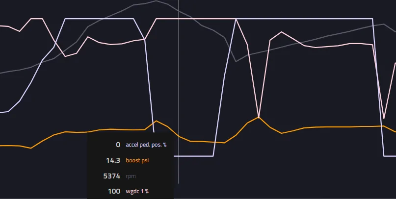

Shoutout David Shoup for pointing out the likely method to resolve this -
Two key points in the calibration:
Also recommended monitoring hpfp angle and IDC.
Now just need to find these tables he was talking about and get more familiar with it.
TLDR: OTS maps suck for MT cars as everyone suspected
8,828
17,320
  • Open loop fueling mid-shift is changed to closed-loop for MT cars
    • smooths out hpfp demand as torque requests jump up and down mid shift.
    • prevents knock getting into next gear, even if single gear pull has great timing
  • much less (almost 0) WGDC during "blow off valve" mode lol
    • Avoids keeping WGDC at 100 the entire time I'm off the pedal, causing boost spike into next gear
  • Softening the clutch protection limiter should help a little too (if the clutch can handle it)

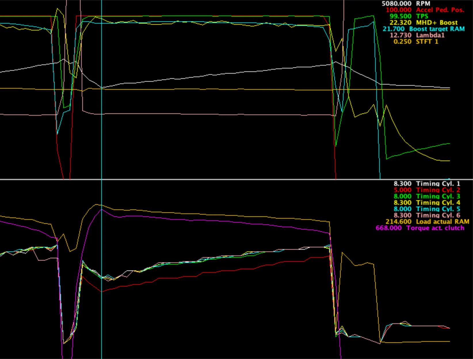

Def something going on. What obd2 dongle?
For reference, here is a MT custom tune log (WIP), with about the same amount of logging items as you.

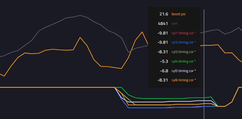

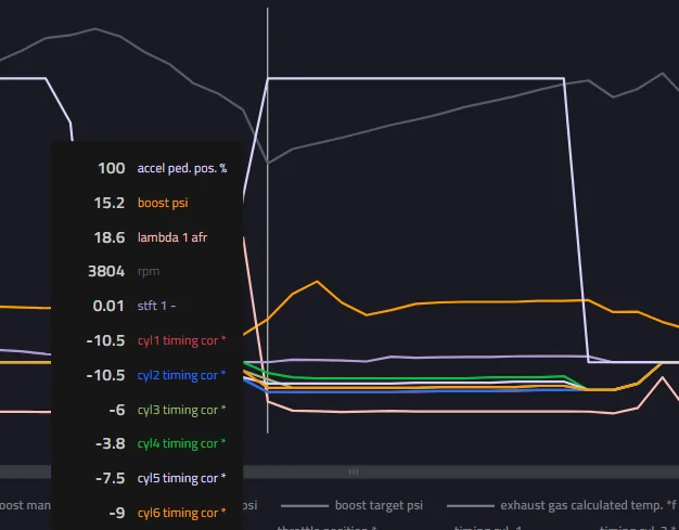

Ah, I didn't even notice the lower gear in your log.
Do you happen to know the table name for the open vs closed looped fueling mid shift?
I think this ultimately is the cause of the 262144 limp mode this thread is about. Car is basically knocking on the shift since it is at 18+ afr and 15+ lbs boost.
8,828
17,320
I think that is more the OTS than anything. Properly tuned they don't do that. Not sure what table he was referring too, although I might be changing it and just calling it something different.
