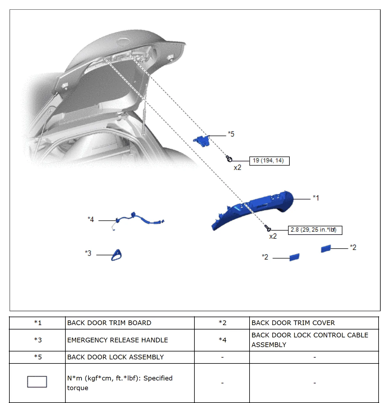

The one thing I miss the most is a factory assembly manual. They used to sell these for older cars, as well as they did factory service manuals, many years ago. The way I look at it is that if the components were assembled with snap-fits or pins/screws (and not adhesive), then they should be able to be disassembled. None of us likes to break things when experimenting, so it may be a while before we know exactly how these plastic parts can be removed.

The Service manuals I've had throughout the years did not reveal assembly exploded drawings/images, as did the Assembly manuals of old. However, I believe the parts person at the dealership has access to those. I've asked one or two of these guys to print me out one , back before we all started having phones and cameras.

Or, since it's the exact same hatch since 2019....
Pop the two little plastic panels that have ridges on them off, take off two bolts, then pop the plastic cover off. Done.

Thanks, Bryan. I kinda thought those small panels are hiding the screws - looks fairly simple to me. :thumbsup:

Wait.. so Adro is cutting into the panels because they're too lazy to design things properly? Ugh.

Well I'll be damned. Didn't think it came out. Why don't more GT wings not take that out and design support under there.
