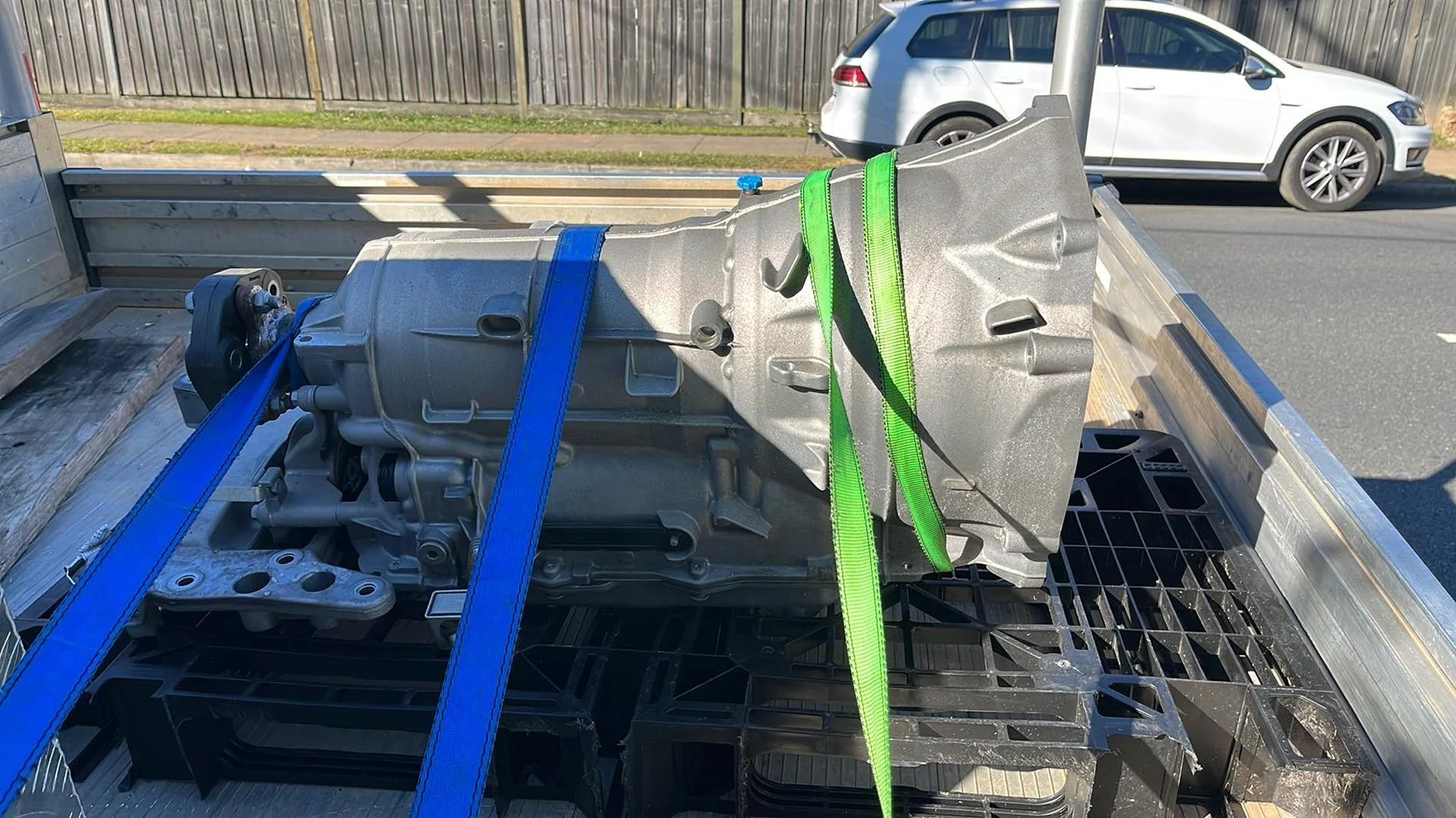

I have bought the transmission!!
Workin with xHP to get a custom map and then will do the install myself.
If i had a hoist the job would be easier...fuck me dead.

Looks pretty straight forward ?. Pcb boards and soldering is my work background so it's nothing.
Tbh the 76 and the 51 are both gen 3 transmissions so there is no need to physically mess with the TCM or the valvebody for that matter. As long as xHP can create the custom code successfully for my vehicle itll be fine.
If they can't then im stuck ???.

If they don't, you can flash the S58 M3 CSL TCU software, or any of S58 car that has an HP76 via E-SYS. It'll probably work fine.
You don't need to touch the mechatronics unit PCB to install it onto another BMW. It's quite literally plug-and-play in terms of installation, unless you're going with an external TCU like the HTG/TurboLamik/Maxx.
There is a chance you might need to interface with the TCU directly through the standard milspec port, but that's only for removing the immobilizer, and IIRC it can be done through the car VIA OBD.

In Europe there are plenty gen 1 b58 which swapped the 8hp50 for the 8hp70 since you find the 70/75/76 in diesels over here(more torque). Afaik it was pretty straight forward, for going from 50 to 70 you need the 70 flywheel and you need to modify the downpipe bracket. Im very interested in what you are doing since I can get a 76 for cheap here in Europe, let us know how it is going on
edit: some more info here on the 70 swap
