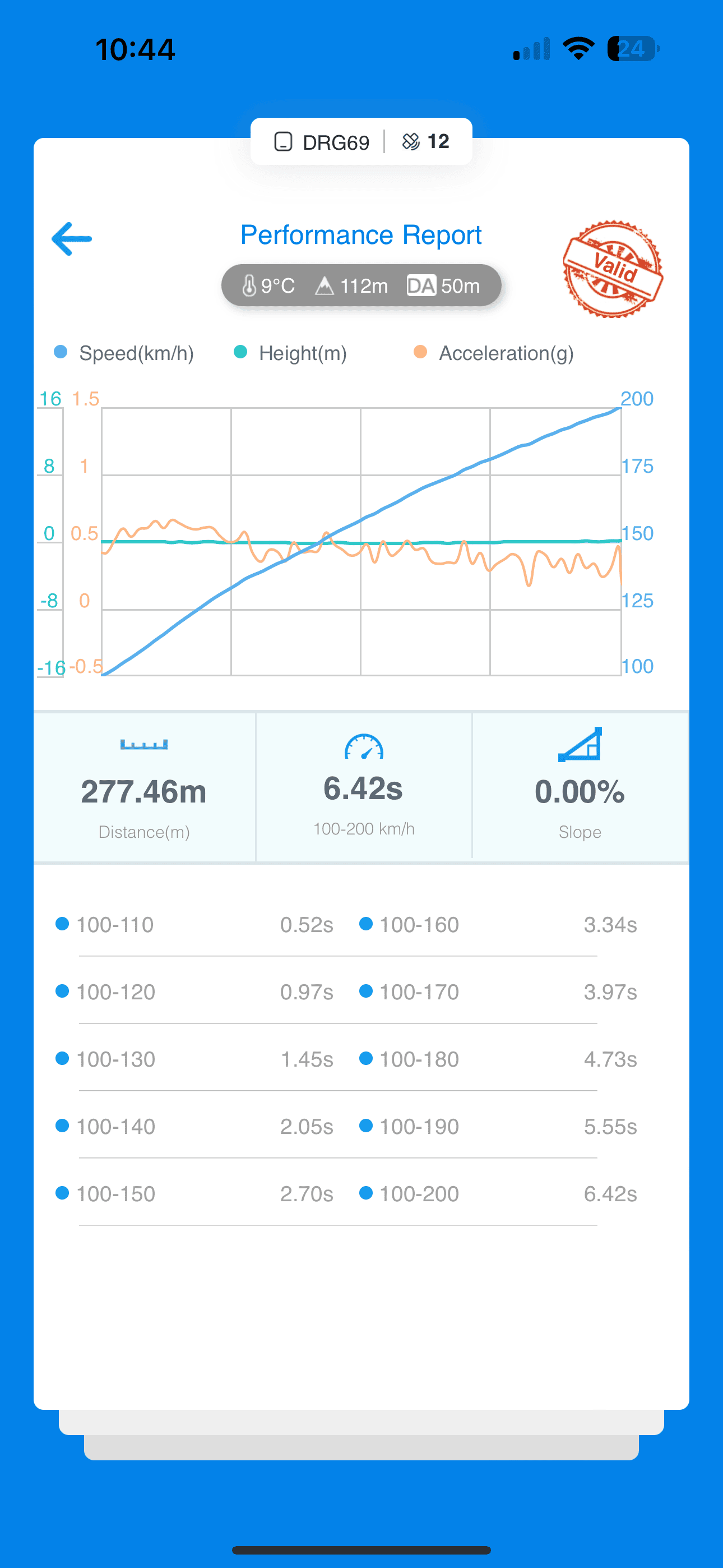

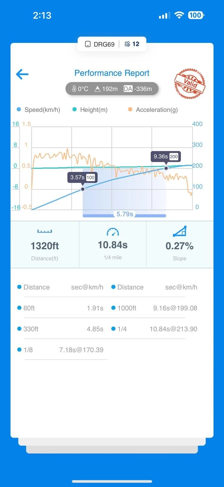

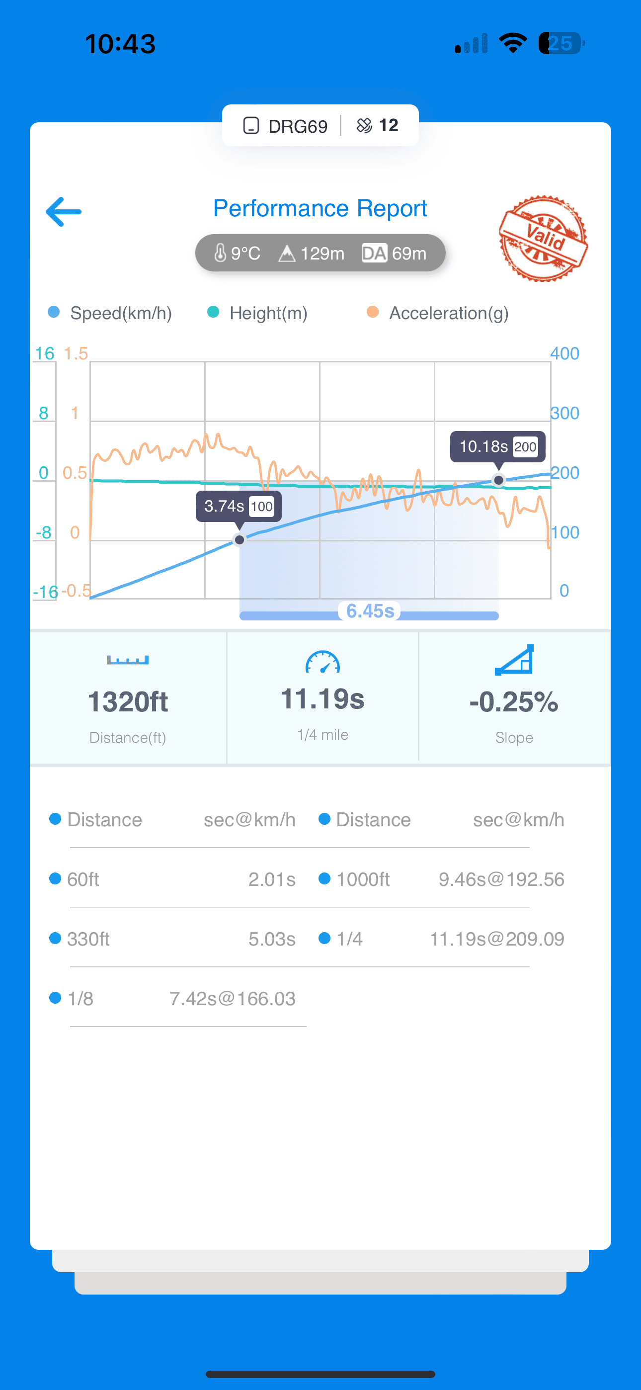

Update : below I share the collected data for the community and the Preformnace gains . Before I post I’d like to say I’ll be also posting more data as I am going to be hitting the dyno tomorrow . With a total of 3 Runs using draggy on PUMP tune the average 1/4 mile was 11.73 seconds for 1/4 mile time I’ll post the best time on pump before upgrade after and on Ethanol. The average time on ethanol E60 to be Exact was 10.88 seconds
on pump my best 1/4 mile was 11.19 seconds after the upgrade . Before being 11.73
on E60 at 26.5 PSI my best 1/4 mile was 10.84 seconds .
mind you I am running full aero which generates 1533.89 LBs of downforce at 200KM/H and because of the aero my transmission is suffering and it’s not happy at all . On the dyno I’ll be running the most boost safely possible on my setup to get you guys the numbers possible with the fuel upgrades and turbo however I can’t draggy at that HP figures just because my transmission does not allow me . Matter of fact on the high way in one pull from 3rd to 4th my transmission disengages completely and does not respond and I need to turn car off and on for it to start working again . Most people will be interested in HP figures which I will post but most of you will be able to get better numbers in drag racing / draggy just because you don’t have the drag or downforce weighing you down . I am going to dyno at 11 am Toronto time and will be posting pump and ethanol results .
“ tuner says that we can push 150-200HP safely meaning as of now the limitation is not fuelling but mostly intake manifold and transmission “ I will be posting after I send my transmission to pure and get the intake manifold from AMS . And as for IAT I am figuring out a way to help them get down by making custom heat shields as well as doing some heat management in the engine bay but intake manifold is a must at this point .
