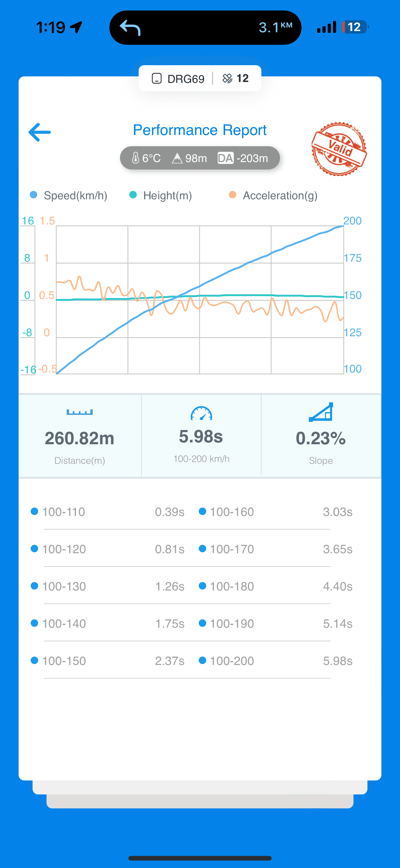

Update : I am spinning in 4th and I did a 100-200 with stock tires and wheels because transmission does not handle the 32 PSI at all disengaged completely and I have to turn car off and on I will be building transmission but a pull from 4th onto top of 5th I got 5.98 seconds slipping gears
