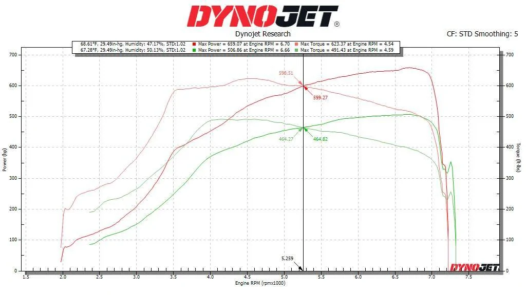

We are currently at 659 WHP on E50 and will try to see the absolute limite of current setup it’s currently running a Pure900 from the Daw I was running . I think maybe we will be able to hit 700Whp on this DI only setup now pretty close right now

how much boost ?
do you see any improvement with the pure 900 compare to the DAW at this level?

Yes , more linear and more top end and dosent blow up

And sorry forgot to mention it’s 30 PSI

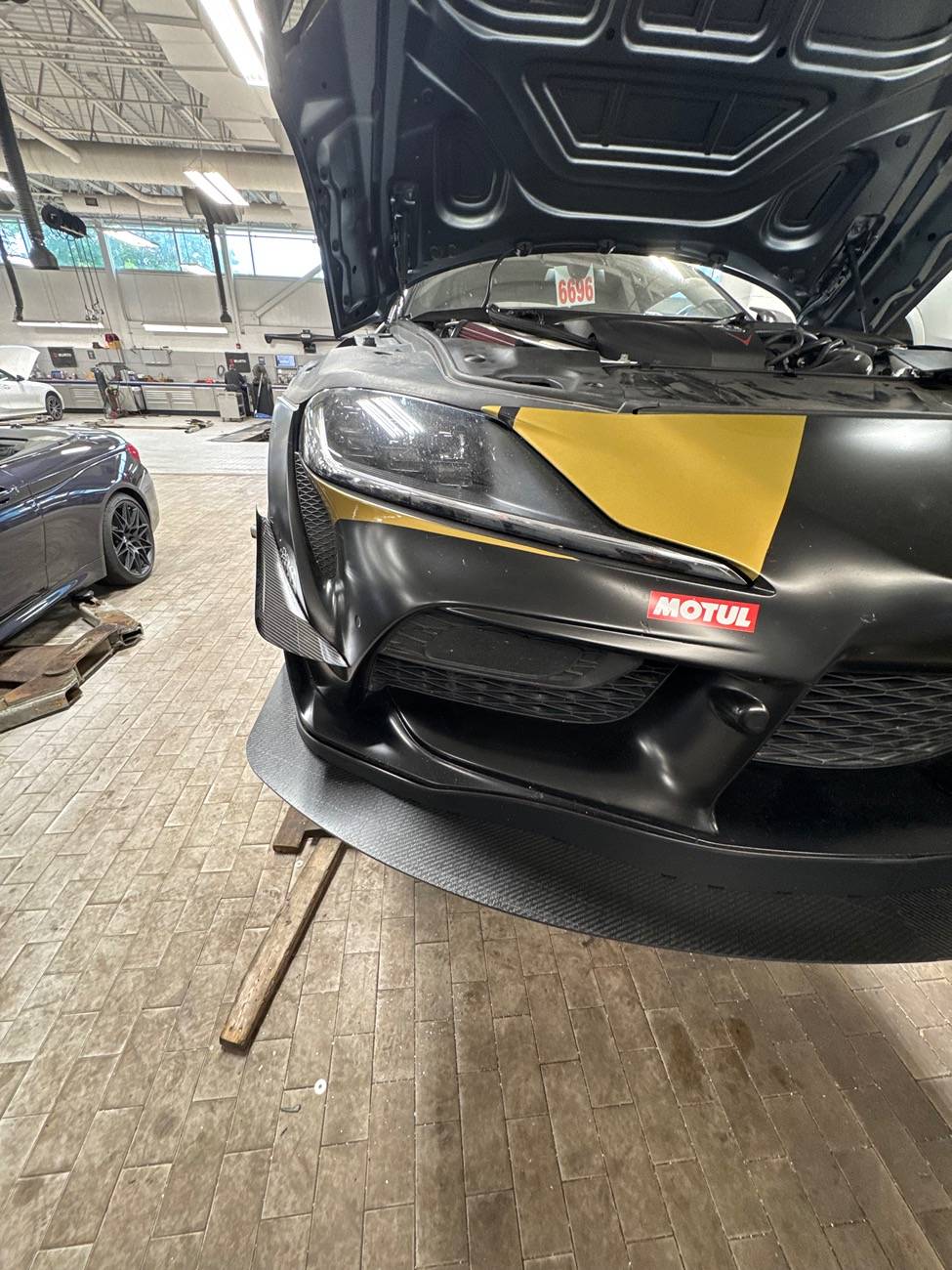

I'll let Verus know about the incoming chargeback when you find out you have to do some DIY upgrades to the splitter to make it function.
DIY upgrades to the splitter to make it work ?
