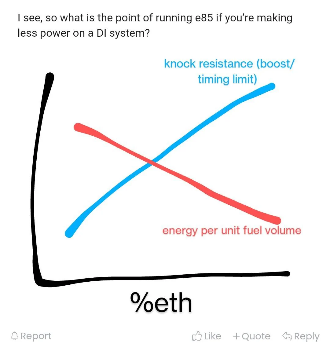

I see, so what is the point of running e85 if you’re making less power on a DI system?

upgrading your fuel system essentially moves the red line up so the crossover sweet spot is higher.

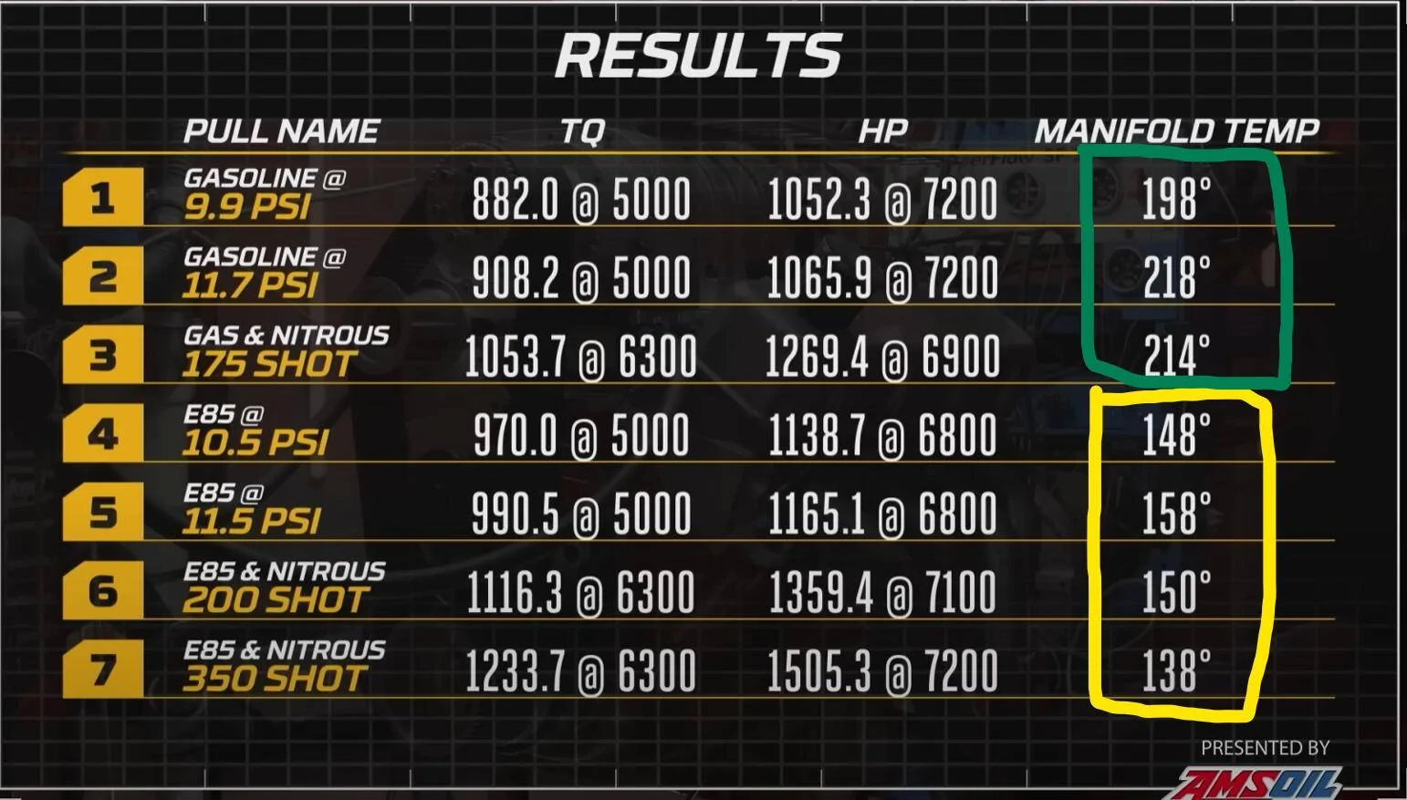

You'll need to think of it differently..
You aren't making less power - on the contrary at the same boost levels you are actually making more power on E85 vs Gasoline; but it requires ~25% more volume of fuel to do so (as Bryan pointed out). Because of this, if a fuel pump is flow limited to 850whp on 93, that means mathematically that same pump will be flow limited to 620whp on E85. (850 - ~25%)
I hope this makes sense - it's my day off so I'm drinking vodka and BBQing ribs and that's the best explanation I could come up with.
Oh also this picture might help. The first 3 dyno entries are gasoline, and the last 4 dyno entries are E85. Couple things I'll point out:
  1. There is a substantial increase to both torque and horsepower when going to E85 from Gasoline at a near identical boost pressure. Meaning with proper tuning switching to E85 is a plug and play increase to power output.
  2. The manifold temperatures are DRASTICALLY cooler on E85. This isn't something I see talked about often with E85 but the fuel temperature stays very cool compared to gasoline and is one of my favorite aspects of the fuel (living in Texas). Cooler fuel = lower air/manifold temps = more HP (especially in a boosted car). - NOTE lower intake manifold temperatures don't apply to the B58 found in our Supras but the temperature drop in fuel is still noteworthy as all things are thermally related in a car.
