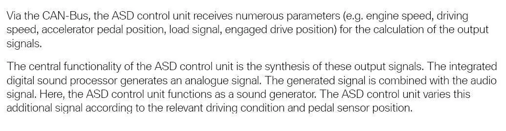

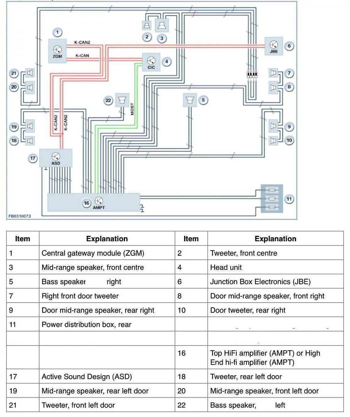

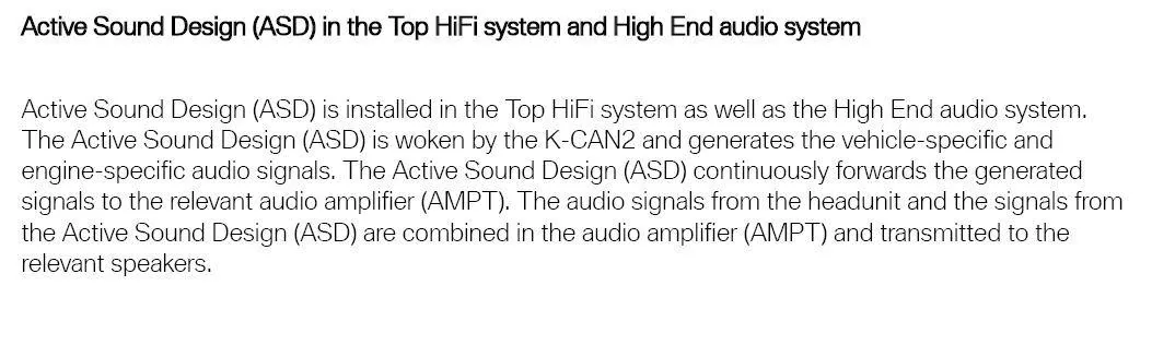

ASD in the Supra is a synthesized signal derived from various sampled parameters and then overlayed on top of the audio signal...I disabled this "feature" well over a year ago because it actually distorts and muddies the audio signal...I'm also not a fan of faux and gimmicky features such as ASD...To each their own I suppose...
Here is an explanation and diagram of our ASD system in our Supra shown below:

ASD in the Supra is a synthesized signal ...
Yup, unfortunately. Just realized that. In this case, I have to agree, it's not something I'd keep on. If it was pumping the actual engine sound, would have been a different story.
