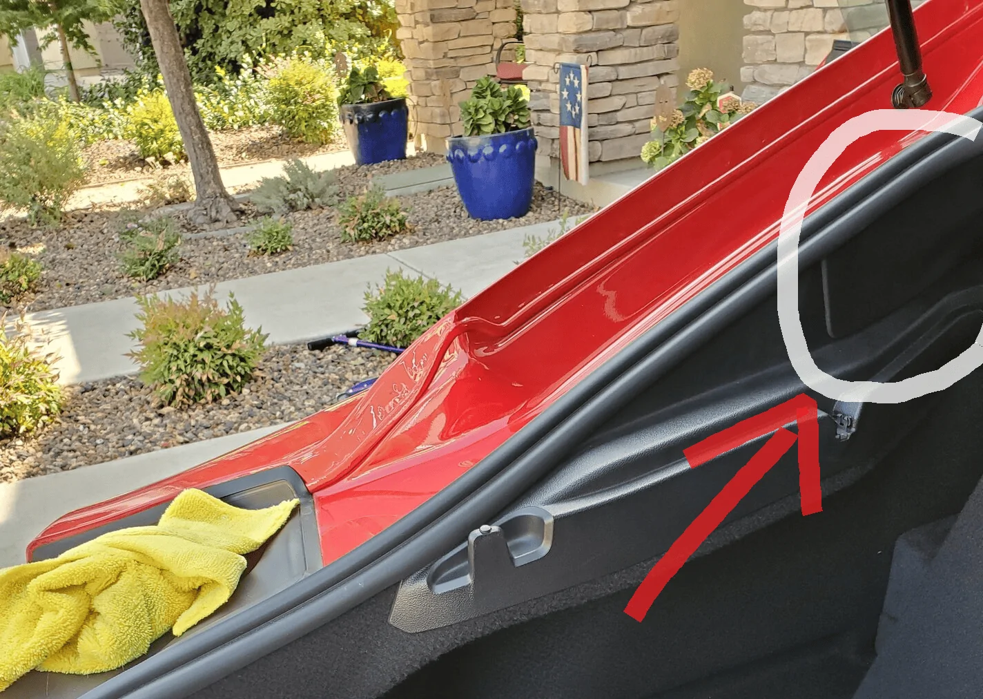

Thank you for the write-up! For anyone else that got stuck, you can see the panel that must come out first before accessing the (2) T20 screws here in KillxPoint's pic:
It is held in by 3 clips, I used a prying tool to get the left two clips out first.
