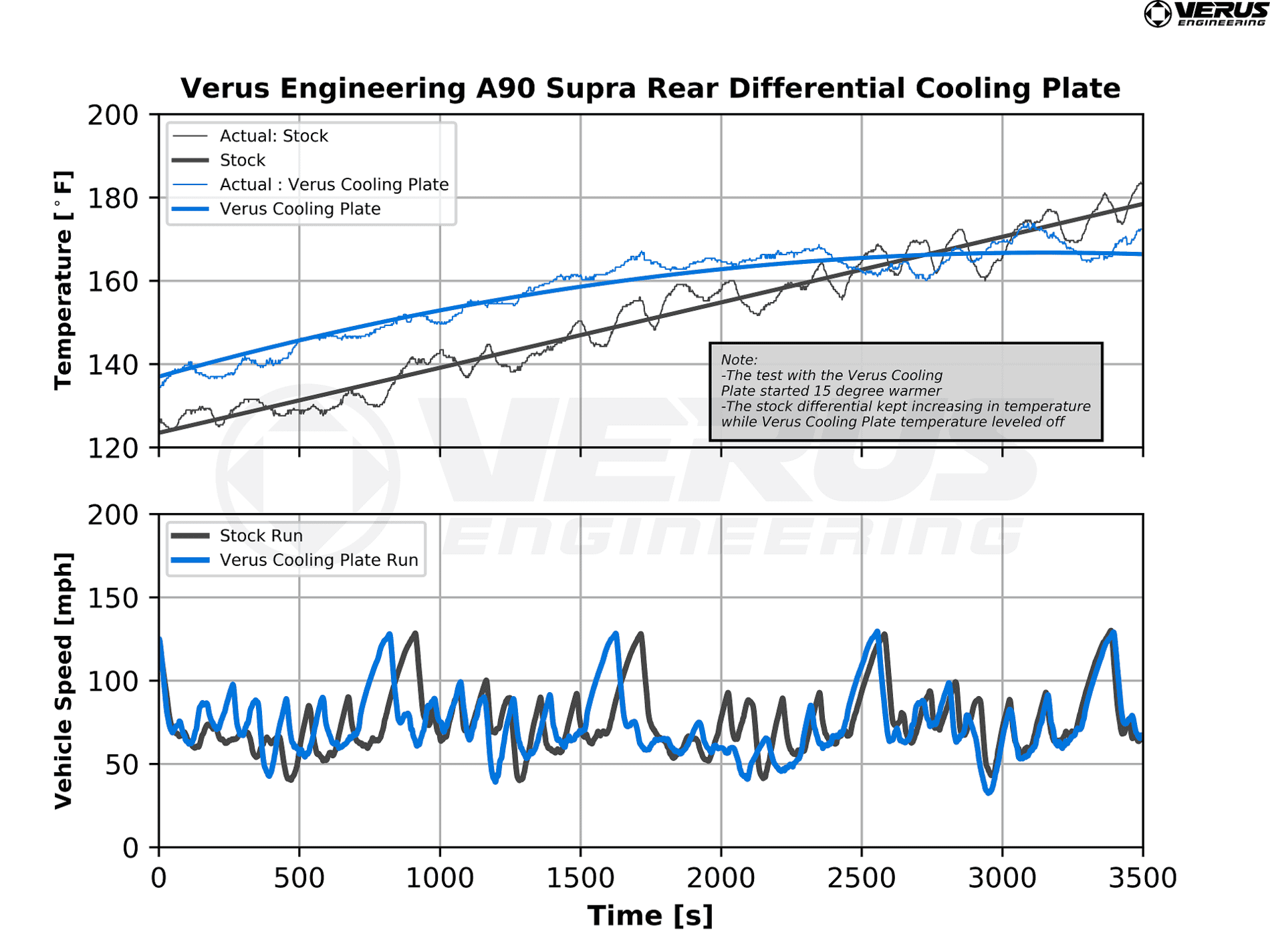

Please correct me if I am wrong but it takes 2500 seconds for the Verus Engineering plate to perform better than the stock differential cooling plate? That is over 40 minutes of track driving before the temperature of the verus cooling plate is lower than the stock cooling plate. I dont mean to be a negative nancy but there is no way that this fixes anything to that extreme from having a code to not having a code. Average track day person isnt going to be doing 40 minute full out track sessions without stopping in between when the car could cool down. Feels more like one of those dress up parts.

The way I read that little statement in the middle, which is poor testing practice, is oil temp in the diff was 15F higher when they decided to slap on the Verus plate, but that's just me being optimistic about this vague description. Perhaps you can reach out to Verus?

According to the disclaimer on the graph, In the large gray box, they installed the cooling plate while the diff was still hot. It would be nice to get some better data from them. It's not very like them to use incomplete data like this.

it seems I cannot read. I know it wont be 100% but assuming we can extrapolate the data to the same starting temperatures it would still level off at a similar temperature and still not provide much additional cooling.

FWIW, I go to NJMP often and I got the diff overheating error at the end of last season. It came on for me after I had some mild tweaks done to the car (more camber and 200tw tires). I installed the Verus diff cooler over the winter and haven't seen the error yet this season after 3 days of HPDE.

I've seen the overheating message once for the diff. This is 1 time out of 8 track days. I was a NYST and did (8) 30 minute sessions on a very hot day. I was sliding the car all over the place when that came one towards the end. If I had the VERUS plate, it just might have kept it on the limit from throwing the light. I might give it a try ...

Update, I installed the VERUS plate and switched over to Redline 75W90 gear oil. I haven't noticed any issues again after a track day at NYST and Lime Rock. I've been monitoring the gearbox temperatures through my EcuTek app. I believe that sensor reading is for the differential. The temperature still climbs as high as 218F immediately after a track session. I don't know what it was before having the cooling plate. The VERUS data provided didn't seem to match what I was experiencing based on my own use. The temperature continuously climbs the harder I push the car.
If anyone else has EcuTek and sees this issue, look for the gearbox temperature live data and see what value might be triggering it.
