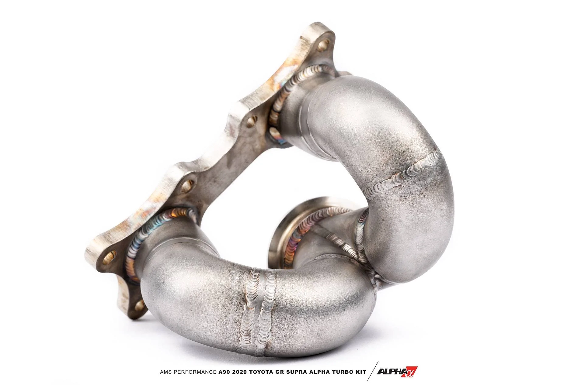

Update:
Big update today welded up the turbo manifold and did a rough install of the turbo and the waste gate today
Jesus, that lag and backpressure must be horrendous. Why not just fab a bottom mount manifold with a turbo that wont have interference issues?

wonder if there any update... if you want to get to 600whp and with headroom to 800whp, I am curious why you didnt just get a pure800 or an equivalent hybrid turbo? I think you will easily get to that power with E85
You really want an update on this dogshit design?
