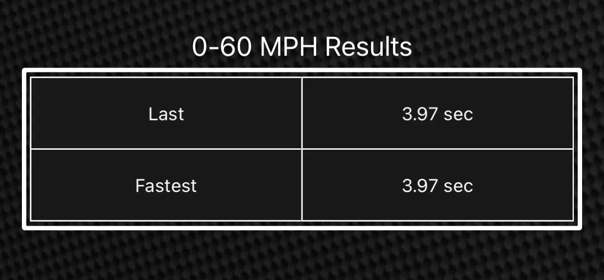

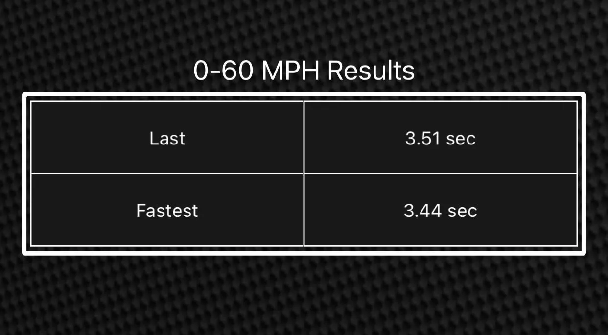

I’ve had it for over a year and the power bump is noticeable. I recently removed it just to see if I could feel a difference going back to stock and it was certainly noticeable.
Take these numbers with a grain of salt but before the install, I was getting between 3.8-3.9 pretty consistently.
With the JB+ I am getting 3.5-3.6 consistently.

Very nice, I use dragy, which 1ft rollout is taken away from results (does show with rollout too but it's not calculated for validity)
Any driveability issues etc?
No driveability issues at all. I keep the dial in the 3 o’clock position and use 94 octane fwiw
What other mods you have?
At the time these pictures were taken only cosmetic mods. I now have an AA downpipe, too.
I wouldn't say my numbers are accurate - I'm sure they are a little on the optimistic side - but they do serve as a reference for me.
I can't find my slips right now but I will also say that I gained an extra 4-5 MPH at the drag strip. Unfortunately when I went after installing the JB+ the track was not prepped so my launches weren't great; I was still getting the same times (12.2) but I was getting 120-122 MPH (up from 116-117). I don't go to the strip that often but I'm looking forward to seeing what the car can do once I get new tires.
