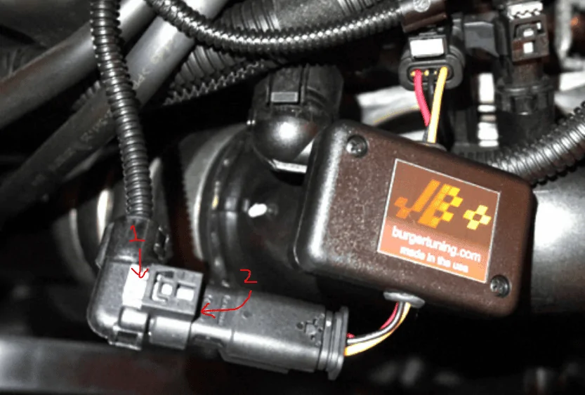

Are there any other tricks to it? Definitely squeezed the tab down and spent 20 min trying to get it off with no luck till my fingers couldn't anymore ? Think it would help to have the car warmed up beforehand?
UPDATE: just use an angled pick to lift up the connector from the back while you squeeze the tab and pull. Idk how people do it without a pick but I got it first try with one.

I'm incoherent, can you describe this in a photo format circled? If you can. Which part to lift up and is it squeezing the white tab downwards simultaneously?
Just got my jb+
This is a pic off of the JB+ install guide that I've drawn on. Pull the #1 tab out. Squeeze #1 down and pull the connector off gently while lightly sticking the pick tool in between the male and female connectors at #2. It came off VERY easily. Don't try to force anything.
You're a Saint, appreciate you!
