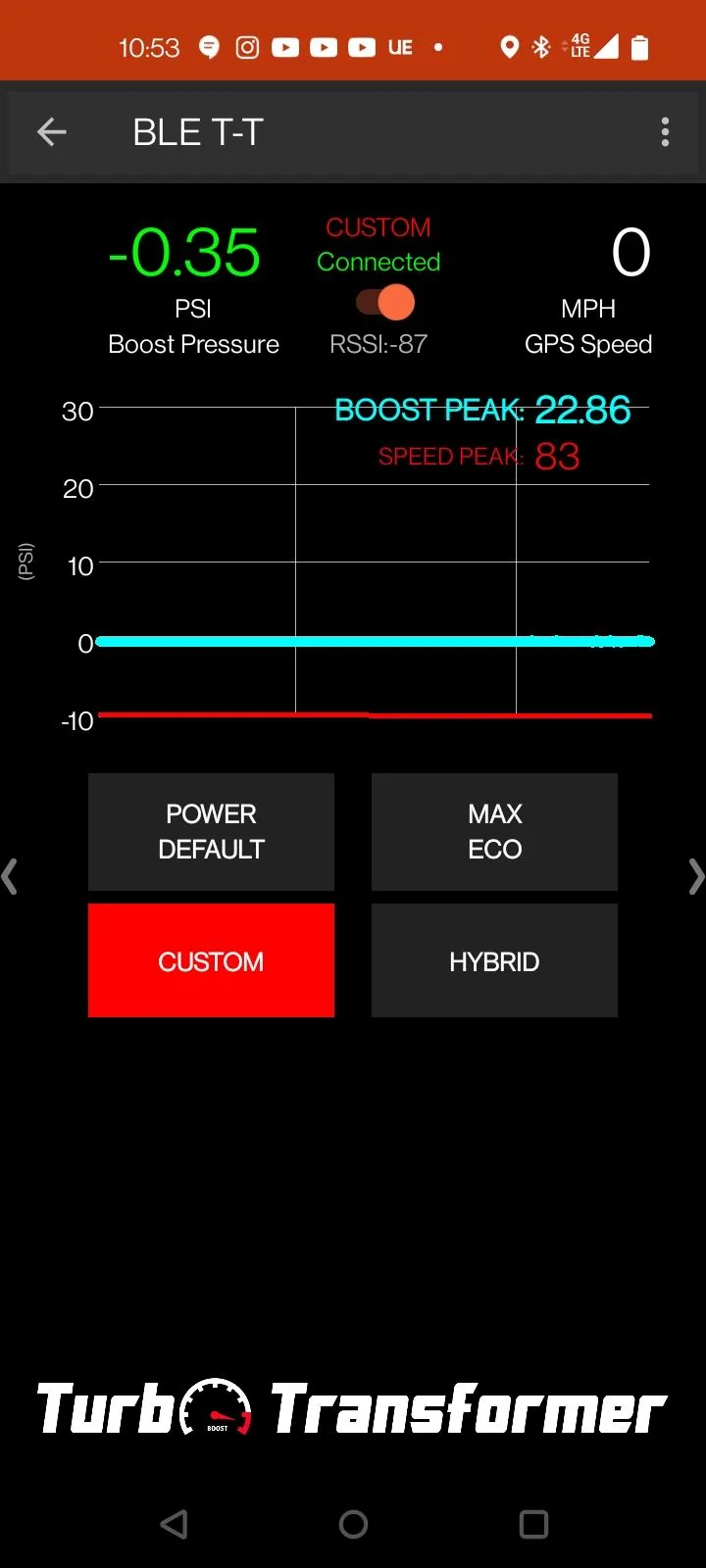

This is with my TT piggyback at +3 with catless dp. This is also why I'll stick to my e25-28 blend. With the piggyback in off position it says peak 16.5-17
