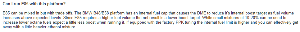

Reading through Burger's info on the B58 JB4, and saw this interesting bit to share:
Boost targets drop as you approach the fuel limit. For us who tried E30+, there must be a level where you start to lose power.
I'm assuming our cars being the high performance O1 engine variant (factory PPK tuning?) means we should be able to handle E30ish without any boost being pulled though.
