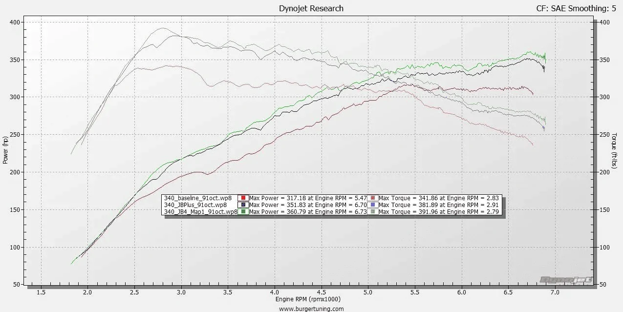

This is from Burger's website on a Gen 1 B58:
Expect 35 whp over stock when running the JB at ~4.0 psi. I'm assuming BMS wouldn't max the JB+ out on 91 oct.
I personally found the JB+ to be much smoother and nearly as fast when the dial is set to 80% ish.
Stock 2023s dyno around 380-390whp so @Syeeee is probably right about 420whp with JB+.
