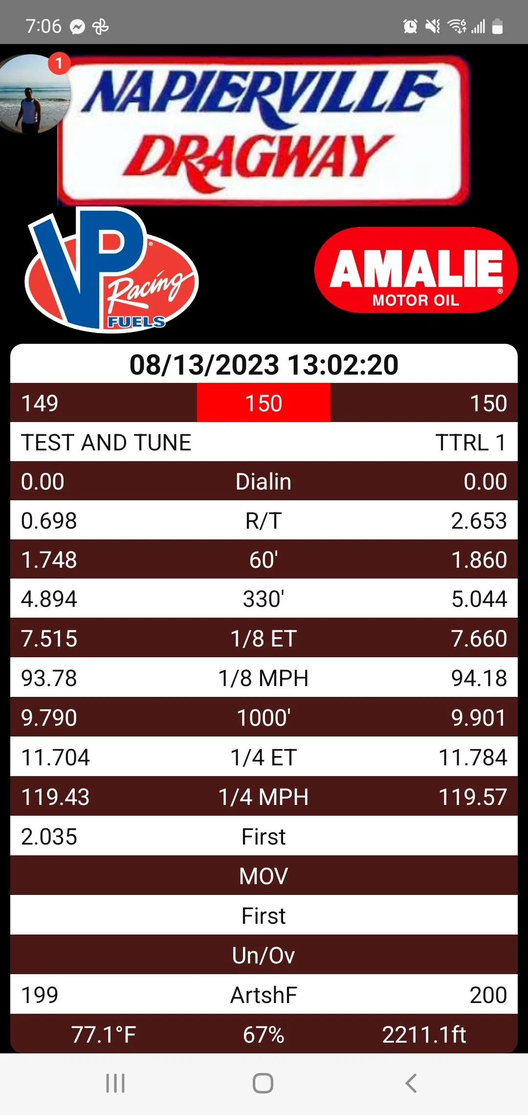

2021 Supra, AA catted DP, jb+ tuner set at default 3 o'clock position. Lowering springs, stock tires, pressure at 31 psi. My numbers on the right, 2019 RS3 on jb4 map 4 in the left. Launched this time in 1st gear. TC, VSC fully off.

Impressive with just dp and jb+ tuner at default position.
I know you previously did 12 flat with just jb+ before
Yes sir, but the DA on that run was in the negative. This run had a bad DA. Still happy with results. I did do another run launching in 2nd, pulled a 11.9 @ 120. 60 foot was slightly worse because I didn't load up the transmission past 1800rpm.
With wider grippier nittos/toyos on the rear, should be an improvement over stock.
I have a pair 285-35-19 NT555r2's that I'll put on for next season. By Sept I'll have ecu back from Femto. I'm more interested in seeing how much of a performance gain I'll see going to the stage 2 OTS 93 map.
