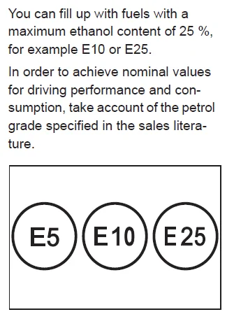

Suit yourself. Taking 3 extra minutes to fill a couple gallons of E at the pump is neither an inconvenience or extra cost for me to do. FYI - Owners manual says E25 is perfectly OK (page 326). Perhaps give it a try before discrediting the 4 of us (And BMS) who have tried it. No one ever said it was a requirement for JB+, just said that it helps with power consistency.

And? Just because it's OK doesn't mean it is good. Besides, without logs you said it yourself:
You realise this applies with or without Ethanol in the mix right?
PLA-CEBO.
Not really willing to continue discussion if you aren't being constructive. If you try the JB+ with and without E and still hold the same opinion, leave that feedback here.

You still don't have your car... and the manufacturer of the product literally said it was okay.
I'm sure they would have tested it.

Does this apply to an automatic, too?
