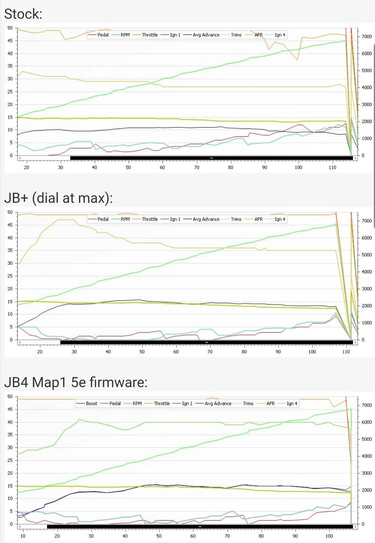

I did multiple WOT pulls to see if I could trigger any overboost or drivetrain warnings but everything continues to run smoothly with my Supra and the JB+ with the setting at the 4:30 position (slightly below max boost).
I was able to dig up some JB+ datalogs from BMS using the B58C engine and observing the changes made to boost pressure and whether or not the DME was able to sustain a proper AFR similarly to stock. According to the graphs, it looks like it does (though I'm curious to know if overall EGTs are increased with the JB+).
