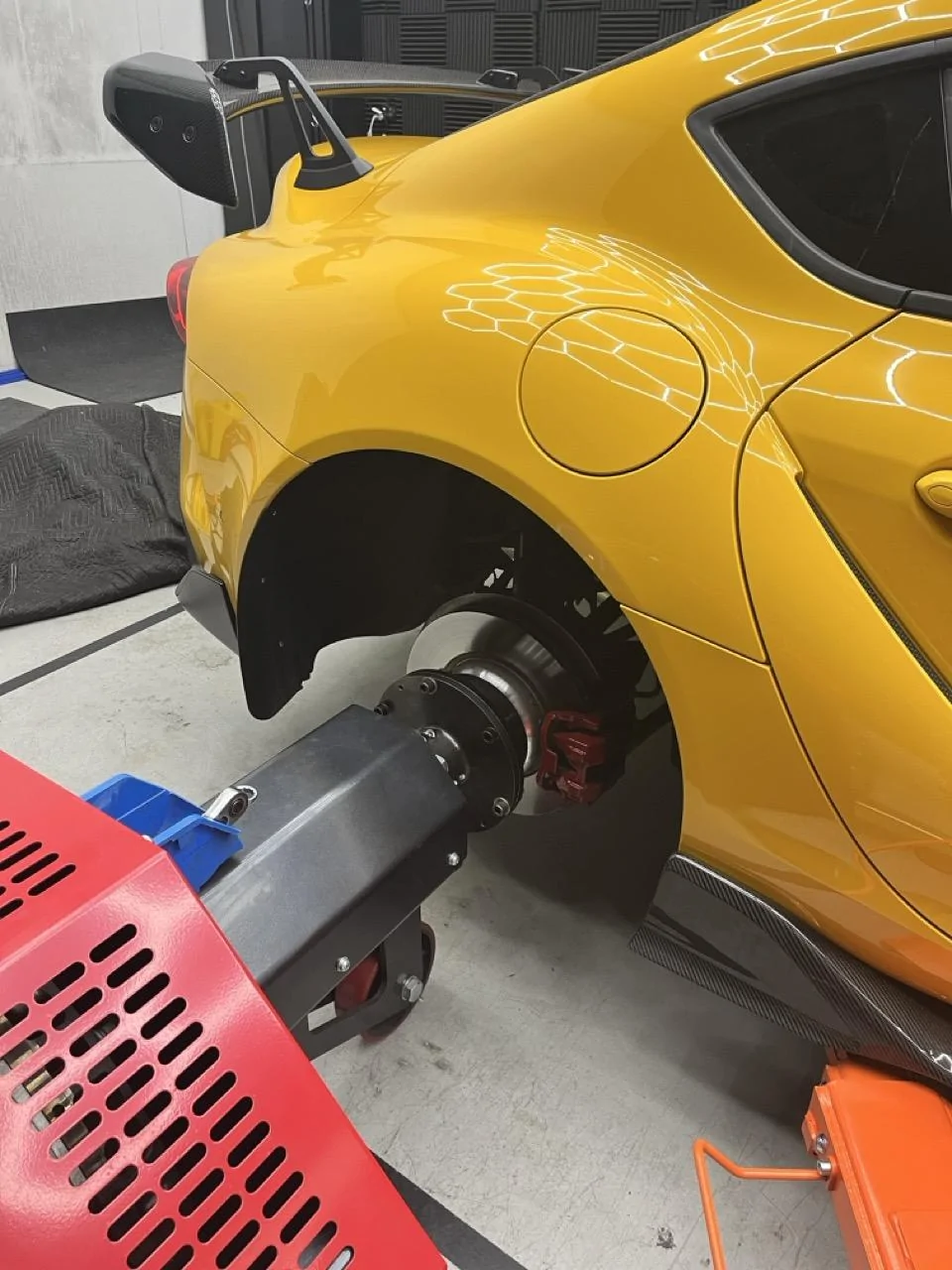

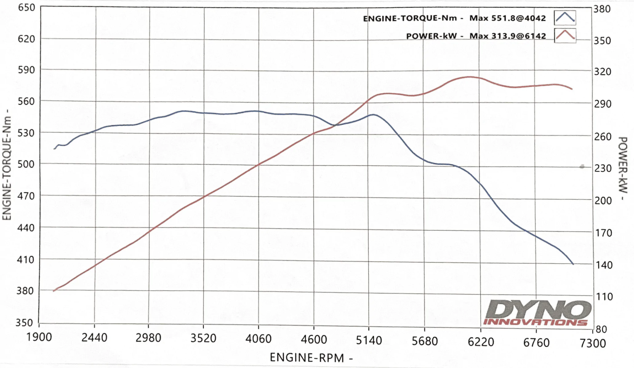

I put my car on a dyno today: My car is a fairly stock MY23 MT running 98RON with an AWE Touring (non resonated) exhaust; NVS Carbon intake lid (resonator delete) and of course a JB+ set at 3PM.
For US that’s about 414 hp and 401 lb-ft?
Was this at the wheels?
Pretty good numbers!

Car and Driver dynoed the stock Supra at 382 whp so that makes it 38 whp bump for the JB+ which is quite amazing
Did you try to remove JB+ and run it stock? Only way to see true gain.
I doubt it's that big a jump to be honest, after accounting for other variables. The exhaust may be adding a little bump too.. not to mention stickers of course. ?
Nah.. I was really just curious to see what the car was doing as is.
If you didn't replace the downpipe I doubt your exhaust added that much. It certainly could be a dyno thing, the before and after would have been nice. Anyway more evidence that the JB+ does indeed add something, and likely a noticeable something for those in doubt.
I want to see how this would look with a catted/catless setup. Probably little to no change

JB+ really doesn’t work that way. 3-4psi boost everywhere power regulated by whether the DMU pulls timing if things get too hot. I would bet the downpipe is not an issue. You would likely need the JB4 and custom tune to see a benefit.
