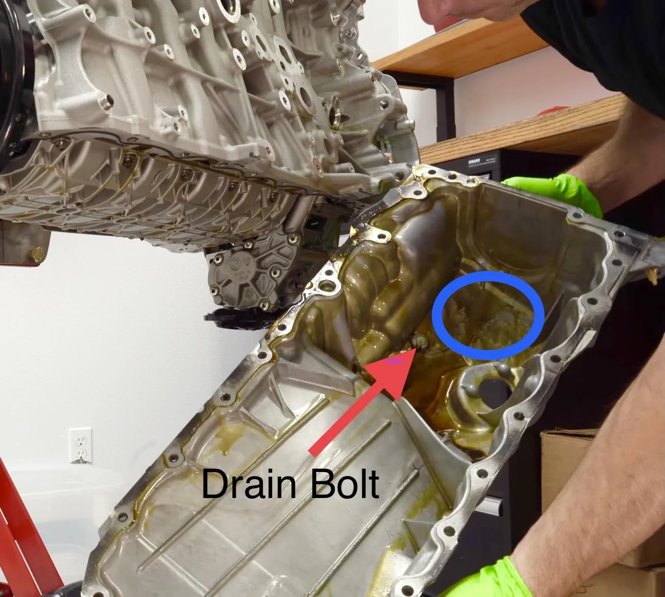

Its never a good idea to overfill your engine oil. Drain it into a clean container and refill properly.
If your car is on ramps so the front is nose high then add 6.5 Quarts. If your car is on a lift and level when drained then add 6.5 Liters.
There is a spot behind the drain plug that will hold oil if car isn’t level.
