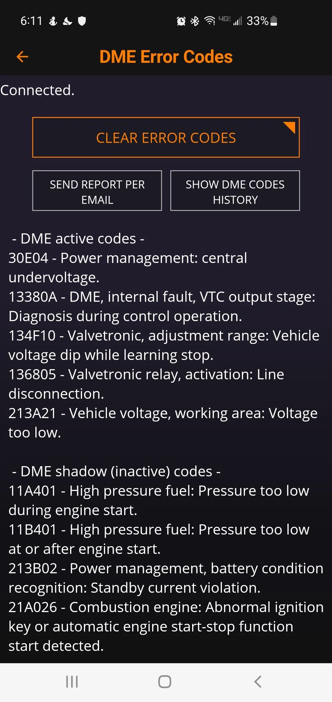

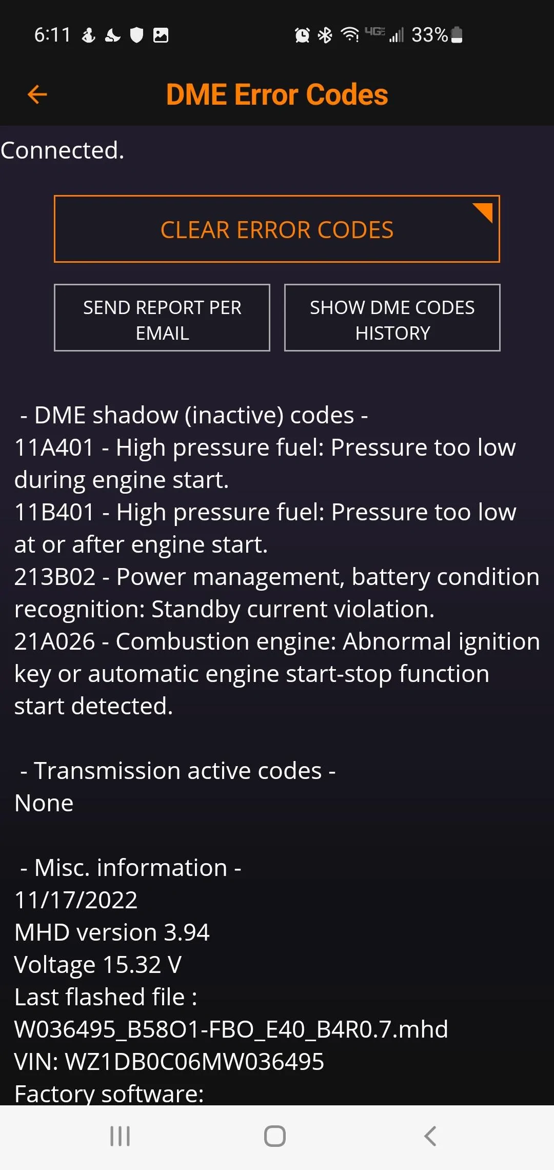

Last night I needed to go Walmart, and the car did the same thing it's been doing except this time, once it did crank, the power steering definitely didn't initialize properly and it had the rough idle. I shut it down, waited 10 seconds, and fired it back up and it ran perfectly fine BUT I had a check engine light. I scanned the codes and this is what I got, pics attached.
(In one of the PICs you can see it says 15 Volts. These codes were ran after the car had been running stable and after several minutes of driving to Walmart.)
It seems to be voltage related, perhaps my battery is on the way out. I don't have a Voltage tester but this car is going on 2 years old now and it was a showroom floor car and the dealership informed me, the day of purchase, that the battery needed to be charged because it had died numerous times due to people playing around inside the car over the course of time that it had been on the showroom floor.
Come to think of it, several weeks ago I went to get into the car and the infotainment screen had a message that said something about "Battery Voltage drop, or low, drive car for a few minutes" or something like that.

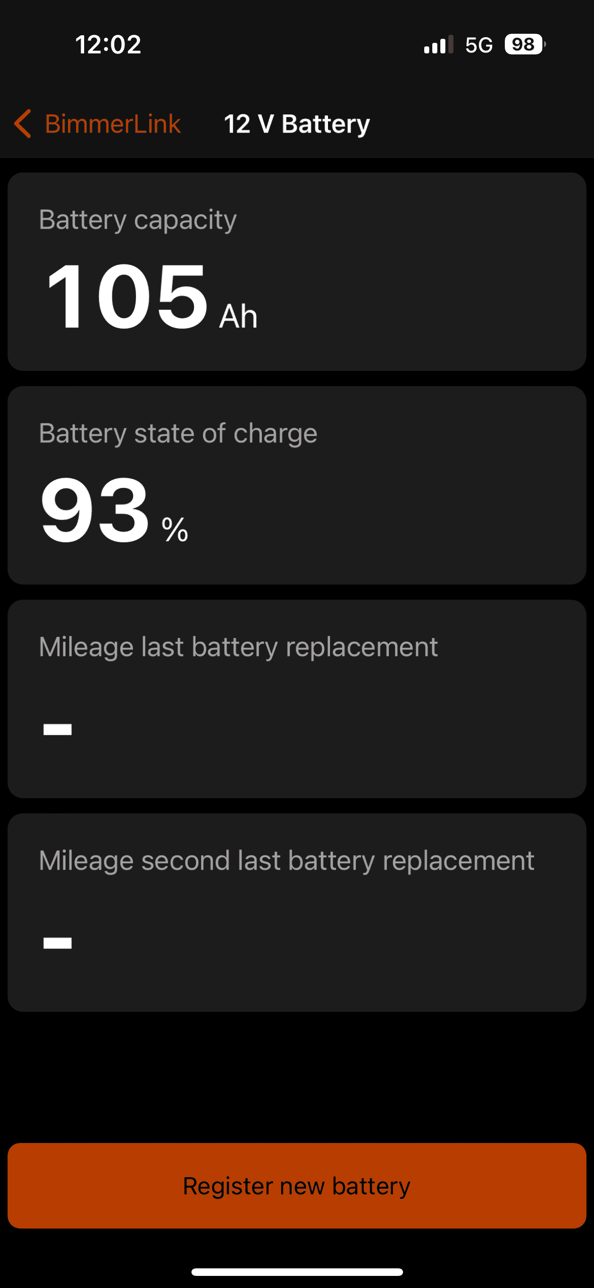

Bimmerlink can also give you a better view into the battery health...
Is this avaliable on the free version or is payment required that features like that?
Bryan / Briana
4,661
9,281
Your moms bedsheets
So, I've changed the battery a couple of times. One factory battery, one an antigravity. I've never programmed anything related to that.
Is it really accurate that you need to do that?
If the battery capacity changes, I think it helps the charging system to correctly charge but I think that’s it. Still “works” if you don’t.

Car has still been having issues starting, still throwing the same codes. I drove it to a friend's house today and it started just fine. On the way to his house I decided to do a WOT pull. Halfway through the pull I got hit with Limp Mode so I pulled over to shut it down and restart it. The car didn't want to start for 10 minutes straight. It just keeping spinning and spinning and spinning over, but never cranking. I pulled the codes and saw all the same codes I've been seeing as previously posted, except this time I saw, "Bad Ground" listed as one of the lines. The thing with that is, all the grounds are still factory and haven't been tampered with.
Finally, I got out and locked the car to let it sit to power down the ECU. This time it cranked and everything was perfectly fine, HOWEVER, while driving to my friends I was seeing voltage spiking up to 18.5V. I'm thinking this issue is going to be more than just a battery. Any thoughts all?
