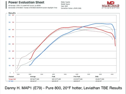

On a Pure 800: +33 WHP, +27 WTQ with no changes to the map -- only change was 3.15" exit DP and 3.5" exhaust to 4" exit DP and 4" exhaust. I don't have the dyno sheet, but I have personal knowledge that this customer was then able to revise their map for more boost and ended up around +44 WHP/+35 WTQ versus their previous best. The turbo was just suffocating with the stock 3.15" downpipe exit.

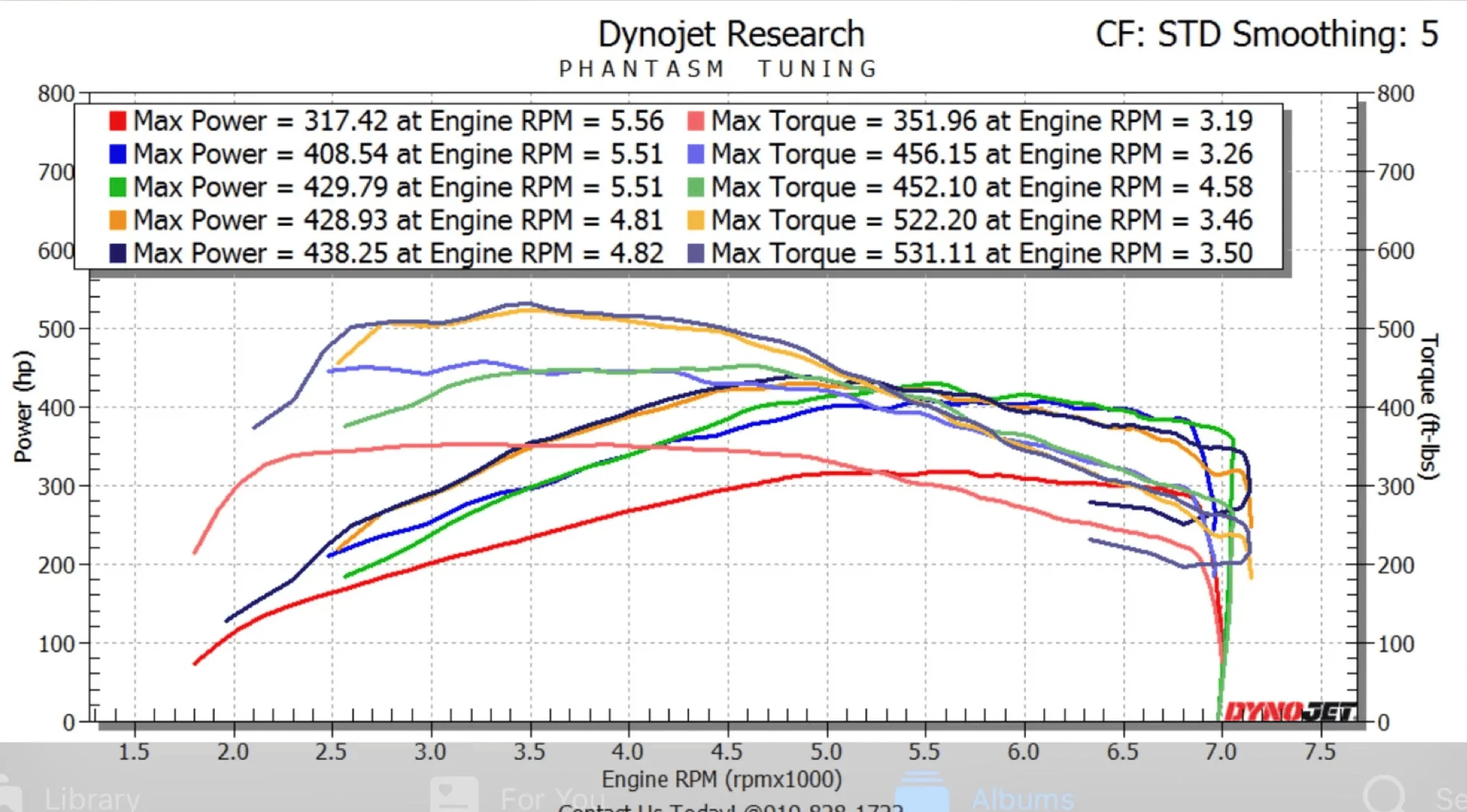

On stock turbo:
Red is stock car (317 WHP)
Blue is stock car + tune (408 WHP)
Green is a stock catback + typical catless 3.15" exit downpipe (429)
Orange is same DP from green + more aggressive tune (428)
Black is 4" downpipe + 4" exhaust + same tune as orange (438)
Customer picks up a nice gain just by removing the restriction of the cat (+21 WHP). Customer makes the tune more aggressive and gains nothing from it. Customer adds full 4" exhaust and gains another +10 WHP on the same tune.
But these kind of gains are not new knowledge. People have been proving massive gains from larger exhausts for a long time, because turbos love large diameter exhausts. It's one of their core principles. The less restriction you put behind the turbo, the faster they can spool, the more air they push, and the more power they make. For example, here's another Supra doing similar in 2011:

This is very analogous to our MkV Supra with an upgraded turbo: Inline 6 powerplant, same engine displacement, similar boost levels. Same debates about exhaust sizing. Turbo cars keep proving that all things being equal, a bigger exhaust is simply better. Every time.
If you get an exhaust that keeps the 3.15" downpipe exit, you're throwing performance away.
