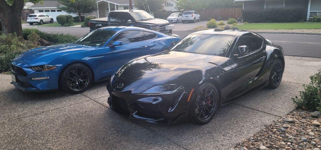

Just picked up a 2023 3.0 Premium in nocturnal. Awesome car! Other fun car is a 750 rwhp 2020 Mustang PP2. New to the supra/bmw scene and would like some input as to the best straighline speed mods that I can do before someone figures out how to tune the 2023's. Downpipe, exhaust, wheels/tires and supsension? Is that the best route to go for a platform to build on once a tune is available? How would you spend $5,000? Pic just because... thanks.
