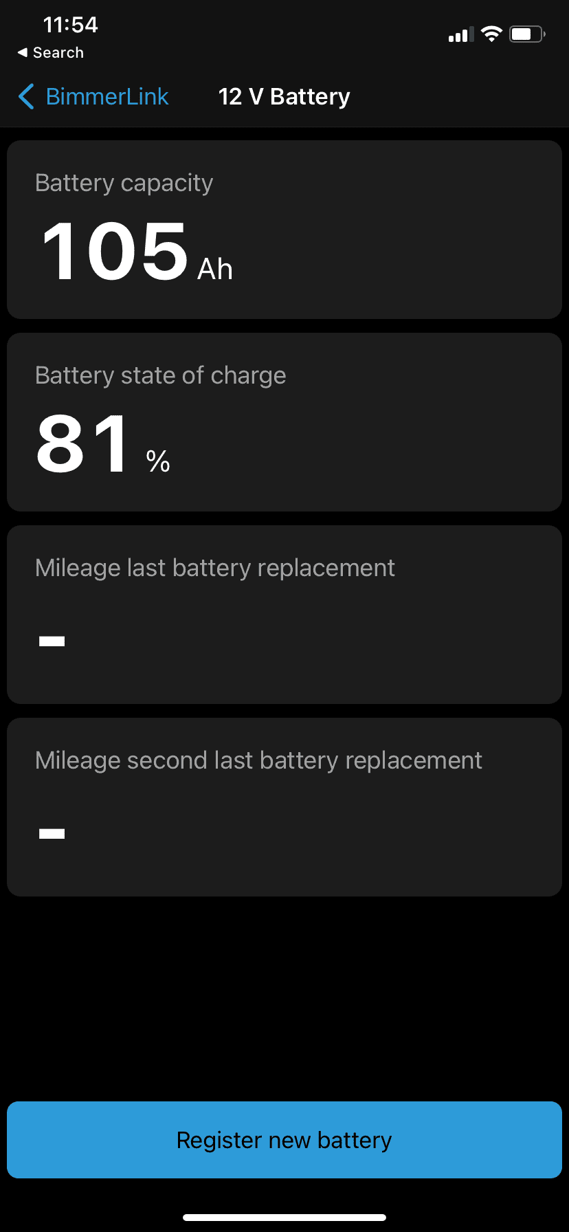

I promise I am not hard headed. Its just that this is my first bmw platform and this is the first issue Ive come across. I dont know if this has any credibility to guess the battery health but this is what I got from bimmer link. Anyway, I dont want the headache of charging, checking battery health, etc…. Whats the best battery would you go for? OEM?

I’m not sure. I’m a little confused. Are you trying to say it’s his BATTERY? You’re not real clear. Just wanting to make sure I’m understanding you. So you think he should buy a new BATTRERY????
op what’s the volts show on the battery? Engine off not hooked to a charger.

I think what others are saying is it COULD be the battery. Having a code that states you should replace the battery means, you should replace the battery. Regardless if it fixes the issue as it will cause headaches down the road.
If flashing the old map fixes it, then you don’t have any worries though right?
