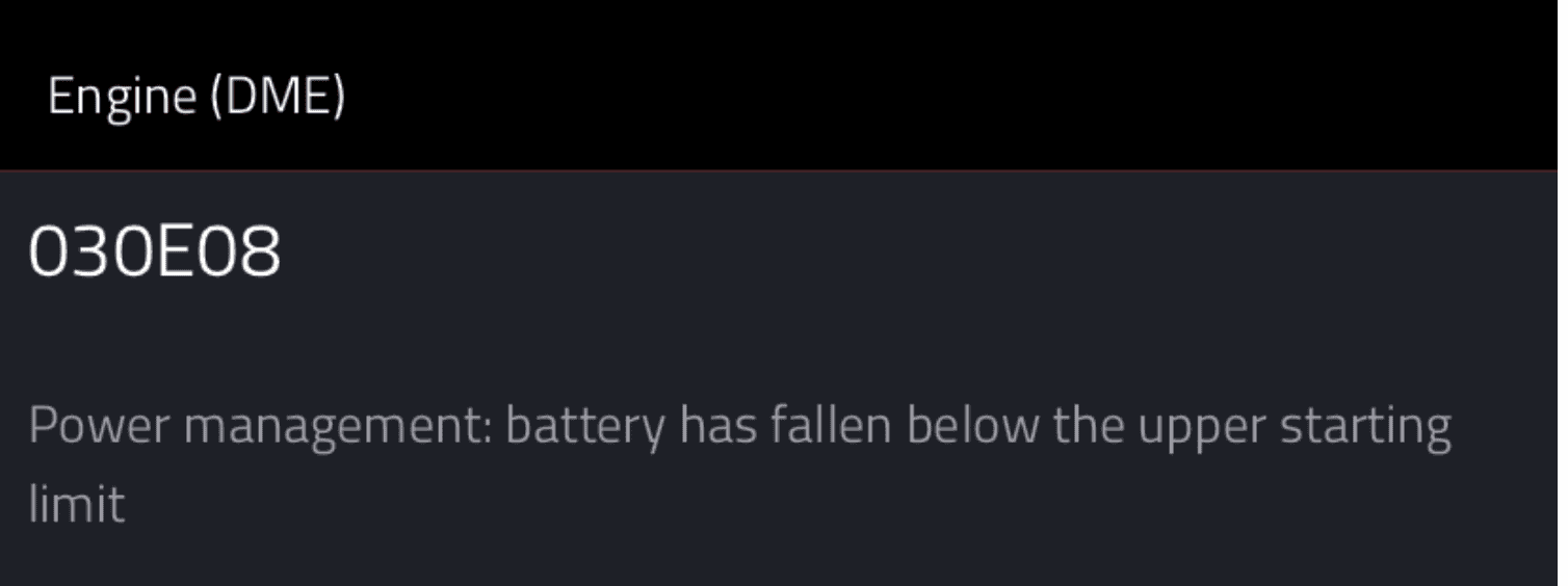

I charged my battery with a trickle and I flashed my car back to my 2.4 version map and the rpm fluctuation seem to disappear but I still dont get any burbles on ots settings. I dont think this is a trans issue.

I don’t think I would trust that battery. I would go buy a new one. A fresh battery will make a difference. At the very least i would test it if you can. A buddy of mine sells batteries and the COVID batteries were complete crap. I bought 4 of them for different vehicles and all 4 failed in a year. He said they had gotten a bad batch. He wasn’t the only one.

Rough running is very likely due to the battery.
The IVM (integrated supply module) that distributes all power throughout the car freaks out when the voltage is low.

I dont know if this has anything to do with the issue but whenever I automatically roll up my windows, my passenger side rolls down midway up.
Everything you keep saying points to a battery issue. Your scan even tells you so:
