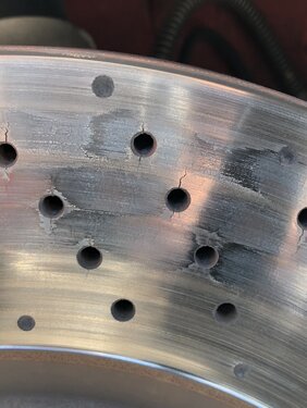

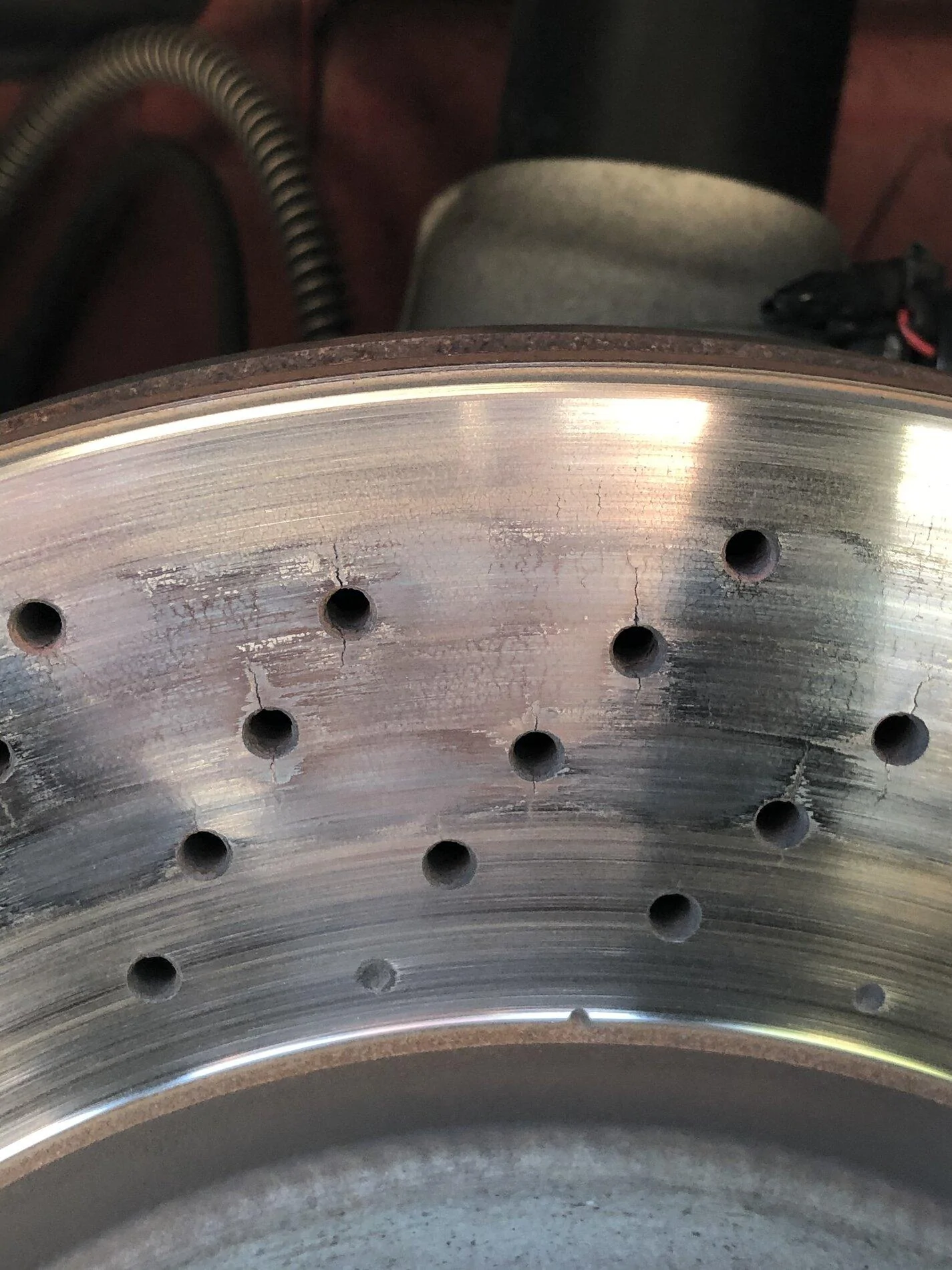

Sounds like a damn train. I need to get the pads changed to something better for sure. I'd like some drilled rotors too.
Drilled are nice looking and if you don’t push your car hard or track it a lot, they’re fine. But I had drilled rotors on the 718 Cayman I tracked and it’s the last time I’ll get drilled. They don’t offer any advantages and they start to get stress cracks after a few track days because of the heat. See photos.
Slotted is the way to go!
