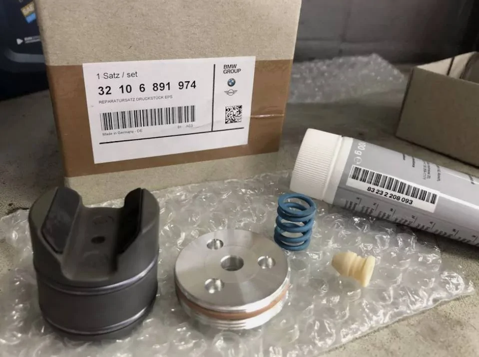

I'm currently experiencing this noise while turning the steering wheel like on the video, engine is OFF. There's no clunking at all during driving or steering wheel maneuvering with engine ON, even when vehicle is parked. Next week I'm going to dealership to have it examined under the warranty. Just in case they need to replace this bushing, I think this is a correct PN from BMW: 32106891974. It's better to be prepared before going to Toyota dealership with BMW car ;)

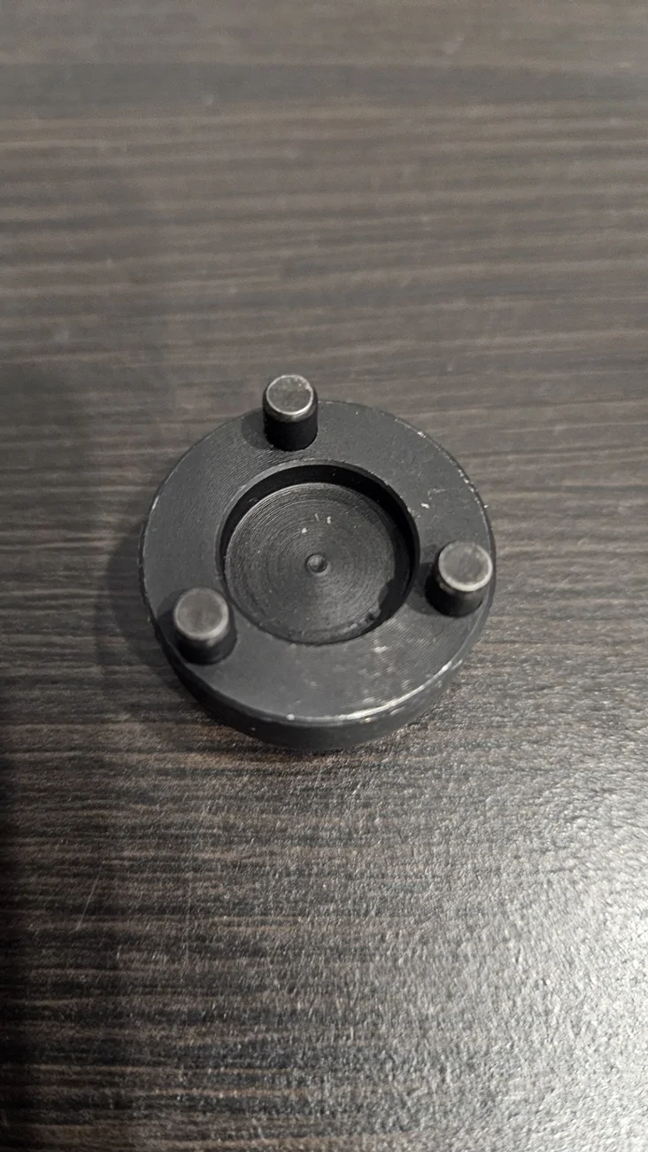

I'm still having a small issue with "metal" noise coming from the left front. I bought this 3 pin adjusting tooling and slightly increased the preload. I did approx. 100km and I think noise was gone however the steering wheel was not going back to the original position as easily as I would like, therefore I had to slightly decrease the spring load again. After that, noise is back (rarely but it's audible) but it only appears when driving slowly on the flat, good condition road ... yes, weird. There's absolutely no "metal" noise of any kind when driving on the bad roads, gravel, speed bumps of any shape, spirited driving on curvy roads. I already checked wheels balance, suspension and did the alignment in the dealer ship, therefore I'm 99% sure the suspension itself is OK. Recently I had a one time situation when driving 5km/h over a transverse shallow "groove" in the asphalt I felt a direct hit through the steering column, never experienced anything like that before on any car. Supra has only 21k km.

NOTE: DO NOT USE THE BMW EPS REPAIR KIT ( Part No. 32106891974 ) AS THE BUSH DOES NOT FIT THE SUPRA ( or Z4)
but u can use the screw cap from the kit ( i did)

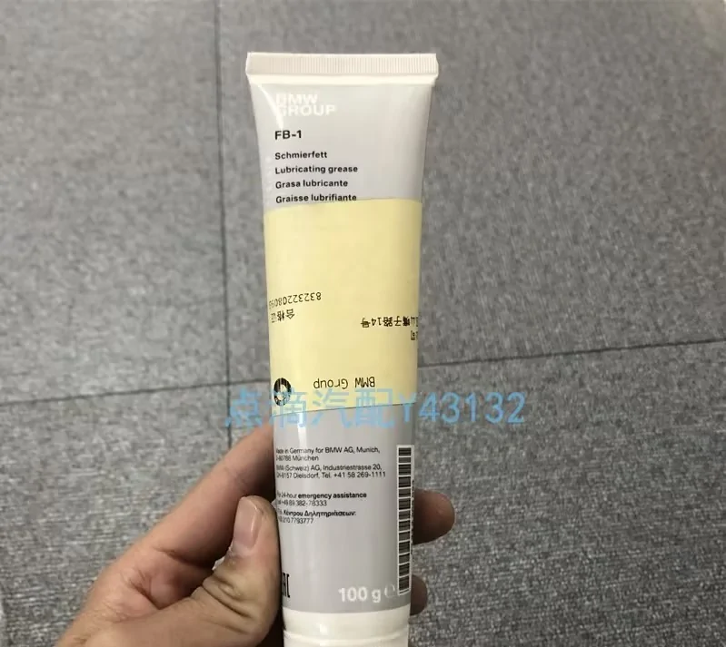

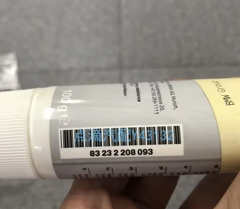

Hello!I would like to ask if the FB-1 grease mentioned is the one in my picture?Thankyou!
Yes, that is what I used. :)

BUT after doing the same job on my 2015 BMW 435i, I thought it was a cheap try for the price of the grease and 3 prong tool (about $35). Add $10 if you don't have a 90-degree pair of pliers.

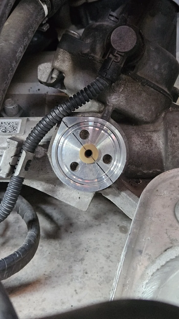

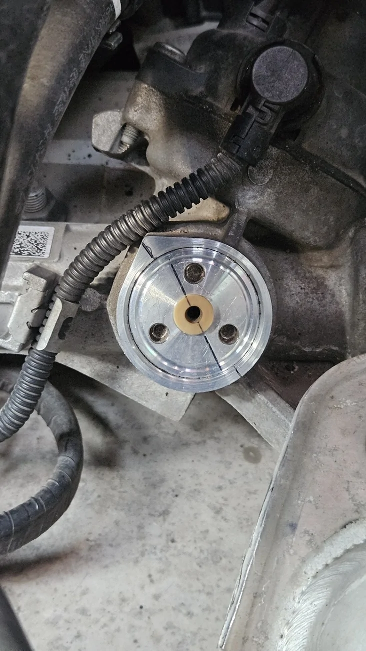

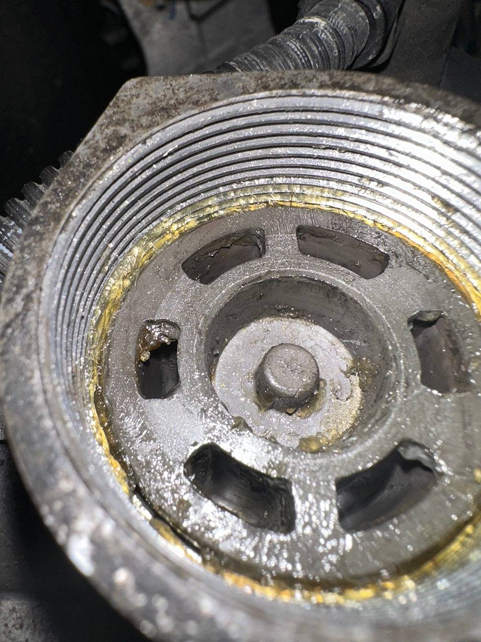

I heard 1st clunk noise when I have driven on my car around 1500km, so on a brand new car. I'm going to add more grease since it worked so well for @exe36m3 but short term solution for me was to tighten just a bit the upper cover, see the pictures before and after. Anything more would prevent steering wheel from going back to its original position.
