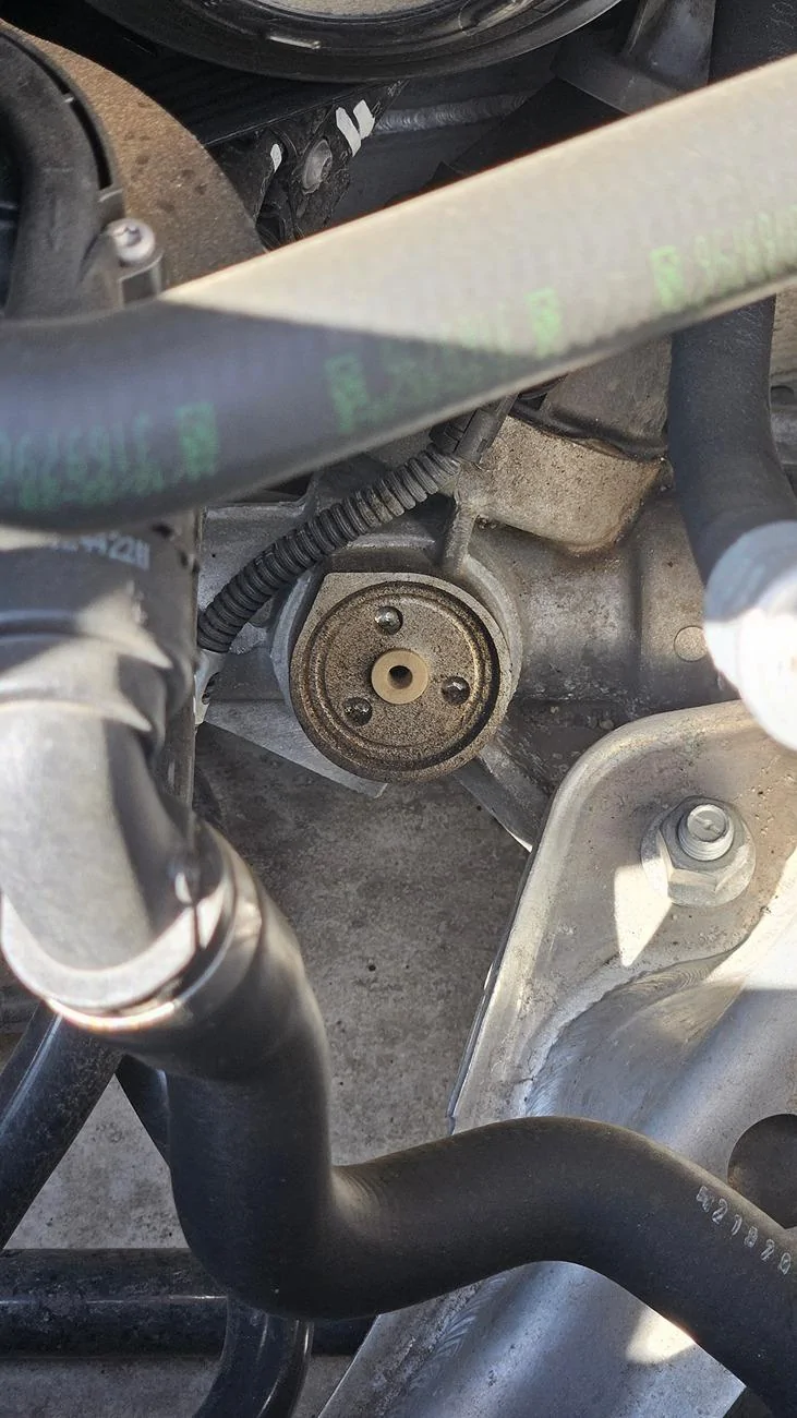

I may have a similar issue. Recently it seems like there's a "force feedback" coming from the left front wheel but it's mostly noticeable on the steering wheel. The feeling is like there is a one time "hit" from the left side of the steering wheel with a subjective clatter noise. I never hit any hole in the road but suspension's geometry was corrected in the dealership maybe 5 months ago, due to NOK factory alignment. My 1st thought was dealership didn't tight something correctly but I started digging into this subject and I got on this post. This happens frequently, when driving straight even on the good condition road, doesn't happen during turning, etc. so that's why I was considering not tightened top mount or something like this but now I'm thinking it may be the steering gear/column. Did anyone experienced similar issue? I'm going to check suspension on my own this week but I'd like to avoid going to the dealership and leaving them the car, especially that they would have to drive it a bit in order to witness this "force feedback" themselves.
I took a picture of the steering gear in the area mentioned in this post and I see grease film on it, car has only 5700km, shall I see the service?

Toyota WONT service the rack ... just replace it ..but thats not and easy job and they will probably cause more issues ... if you try to adjust it yourself be very aware a very small amount is required.
8,568
16,804
Hudson Valley, NY
I second this. Do it in VERY SMALL AMOUNTS. I am still adjusting mine to not be too tight. You will 100% know if it's too tight as the "self-centering" that happens when you turn and start to unwind the wheel and go straight no longer happens. Makes the far feel "sticky".

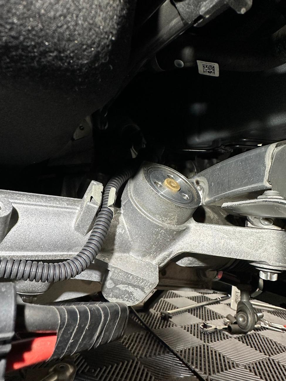

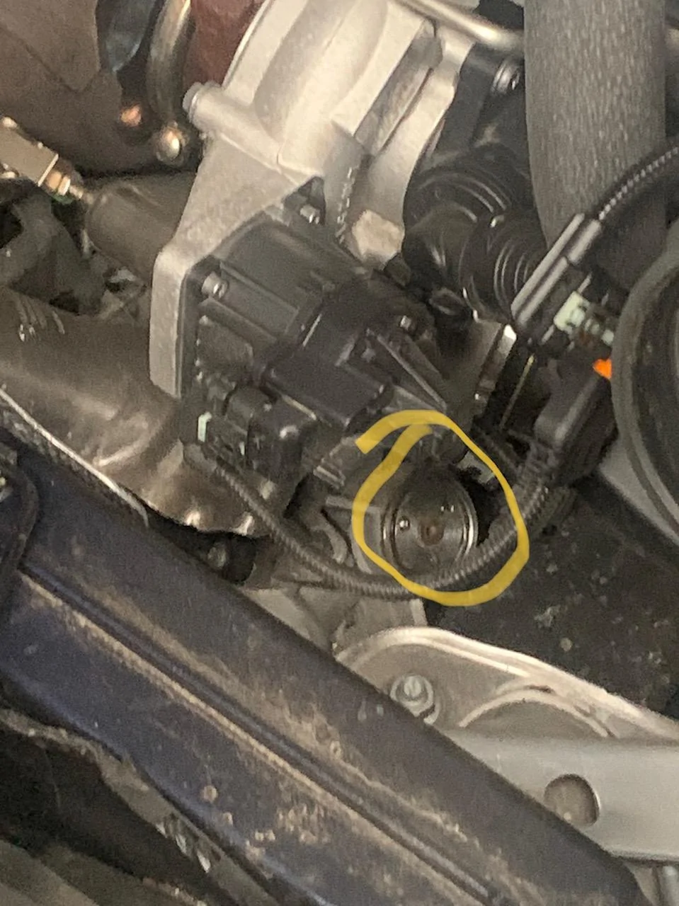

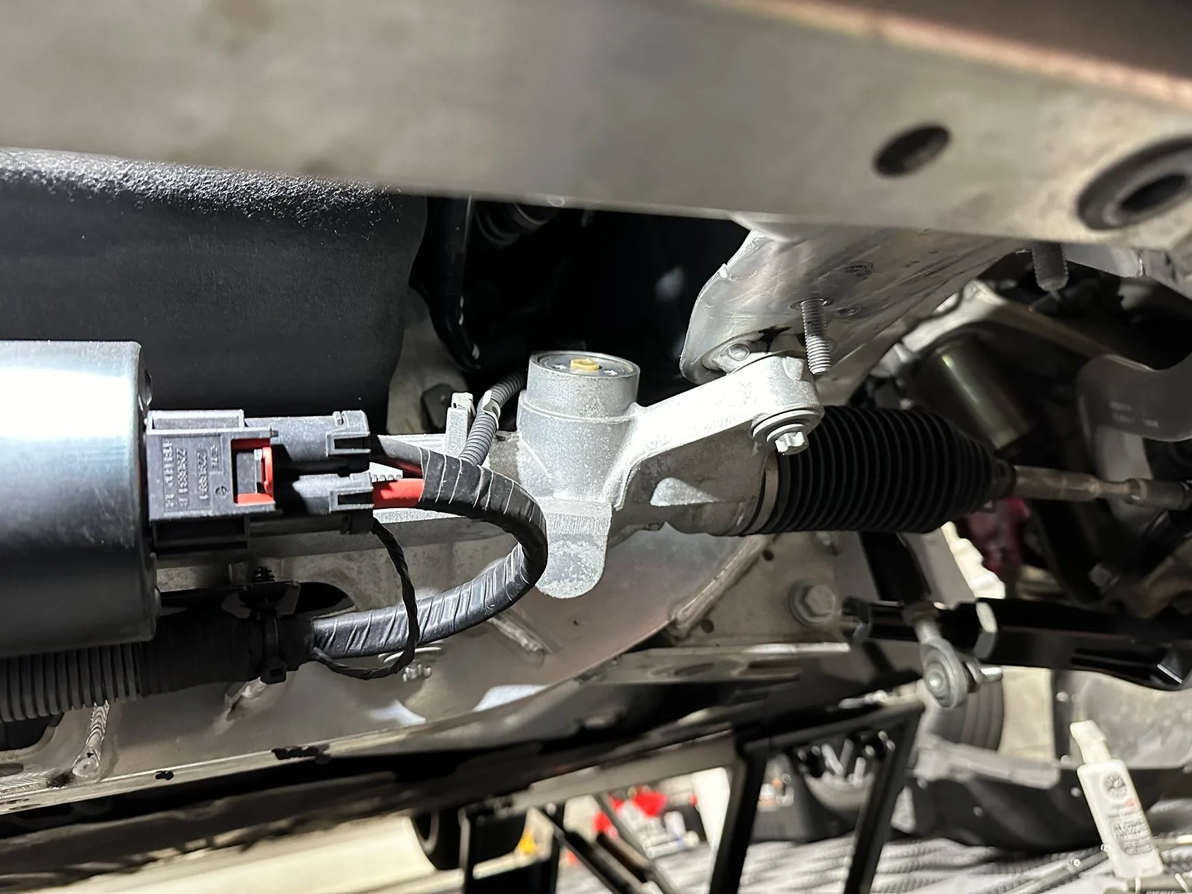

Also for people wondering where it is located on LHD models. Here are some reference photos I shot awhile back when I was under my car.
This is after taking off the metal undertray:
