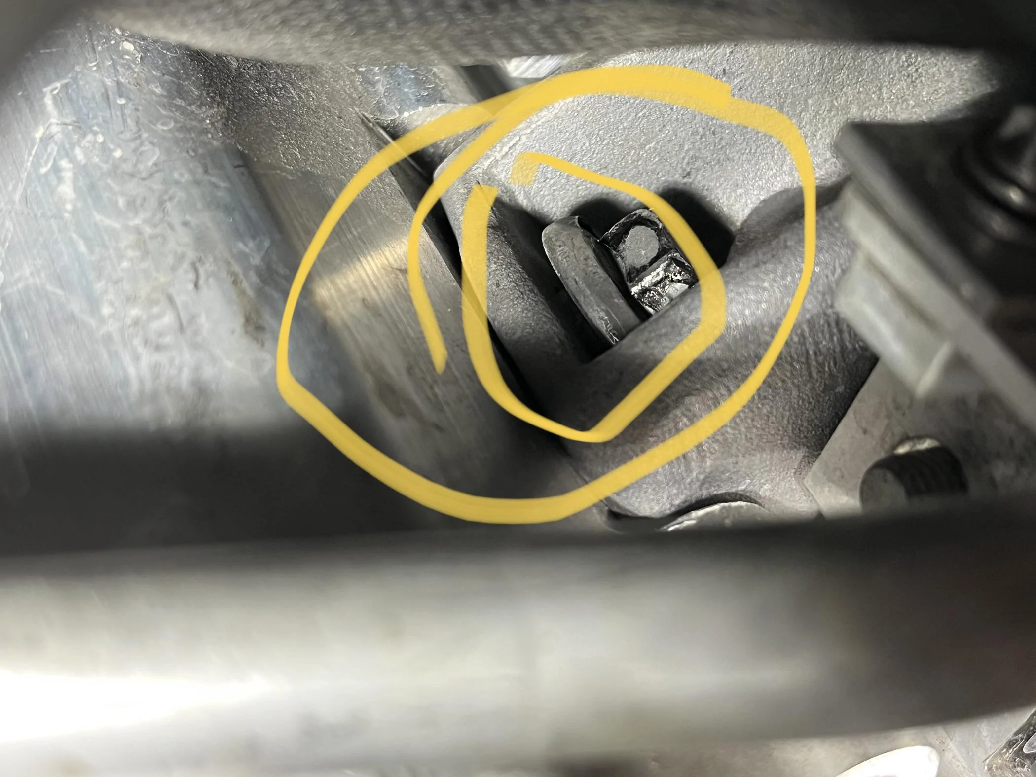

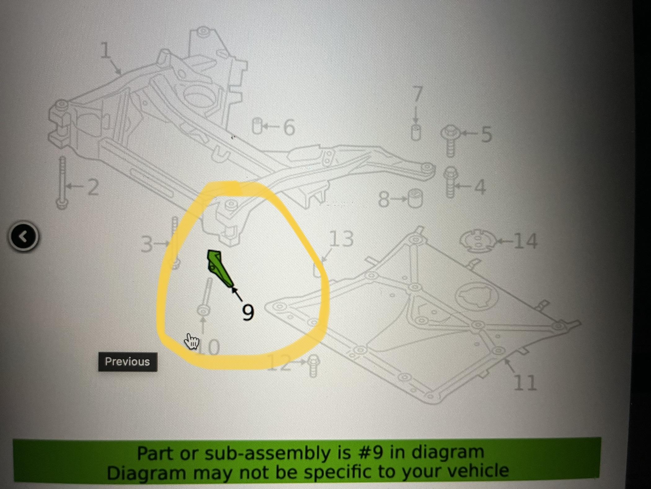

I hate to bring this thread back from the day. But this might help someone. Okay guys I'm new to the 2020 Toyota supra. (I had two MKIV and one MKII.
I bought a 2020 launch edition with 16k miles. I heard a clunking noise when pulling into my garage the first time. It kinda sounded like when you drive into a garage that has the screens with the scree tracks on the ground or like a Brake pad floating. I didn't think anything of it. But it got worse. So I made an appointment with the local Toyota dealer. So I sat in the dealership for 3 hours only for the service rep to tell me they think it's the front left strut.. They let me leave without a true diagnosis.
(The do not mention if it's safe or not to drive or not). So an old buddy out of the blue calls me and I tell him my situation. He says "I think I know what it is". So I head over to his house and he opens the hood and jacks the driver side up. While he's under the car with a bright light, I notice a bolt backed out on the driver's side and the same bolt on the left is in further. So my clunk was loose bolt in what Toyota calls a bracket part# Toyota 511-WAA01. This bolt was on the verge of coming out completely which would have been bad if I were ion the highway..1st pic is the part. 2nd is the bolt that was loose. You can still see it has to be tightened more. (Not much room to get more that a 1/8 of a turn so I took a break LOL)

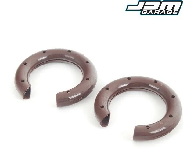

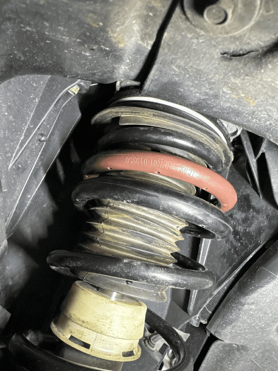

Anyone have a diagram of how the front spring wraps should be installed, similar to @Thraxbert 's post?
I've got the same clicking in the front exhibited in OP's video. Nothing on turns, just sharp bumps.
Added some Tein silencers, but wondering if I still have a portion higher up that's making contact? The Swifts came with a single wrap lower down but there were still contact points.
