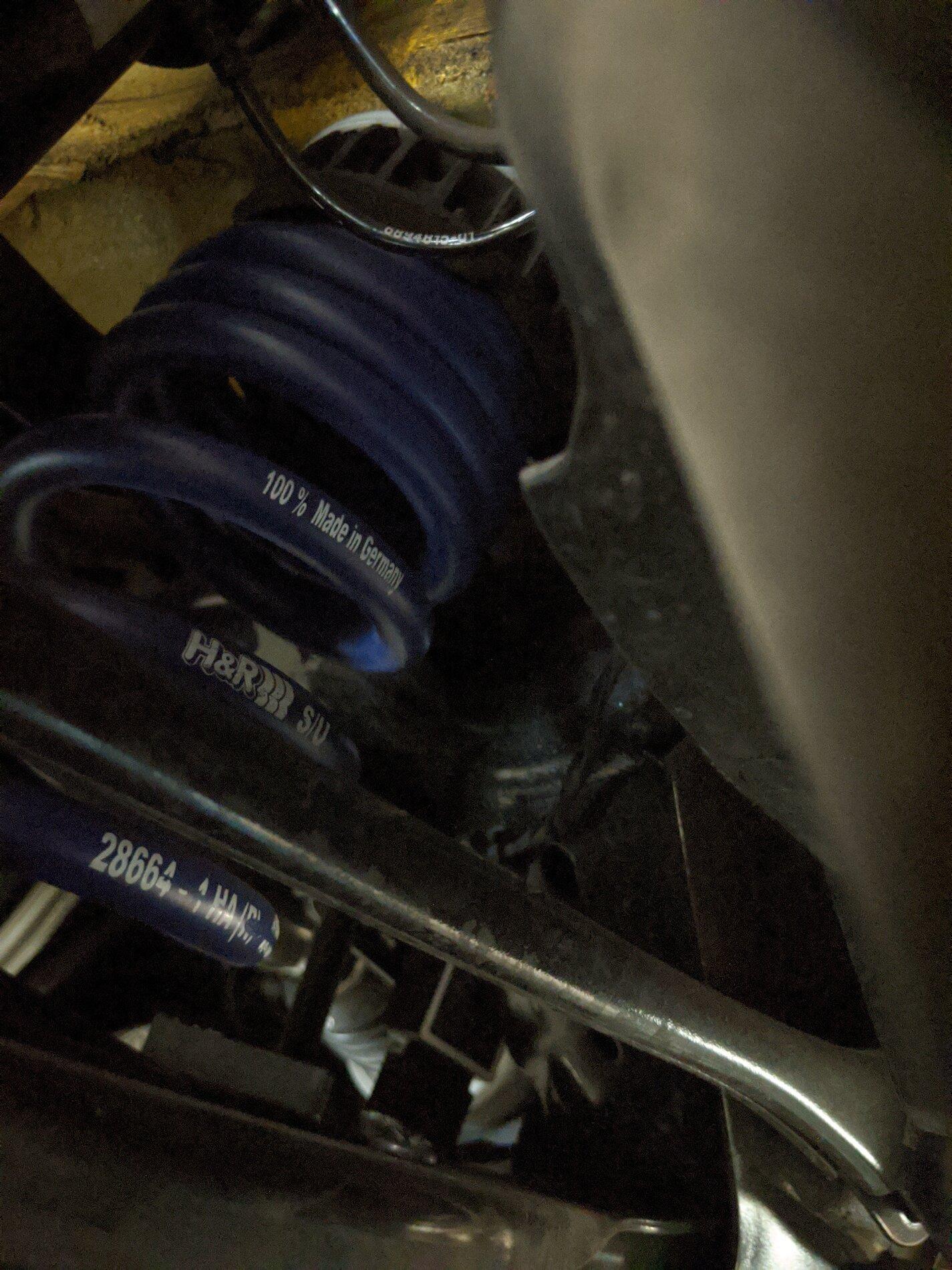

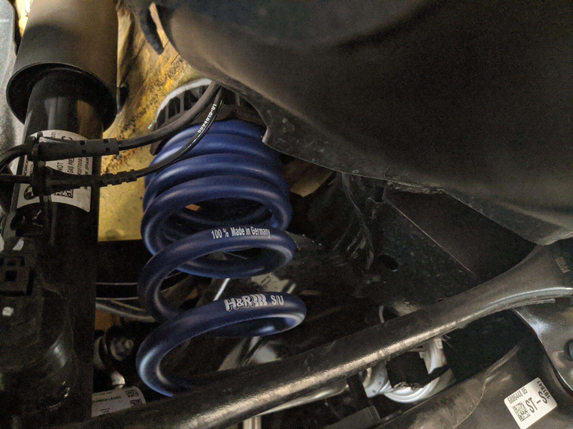

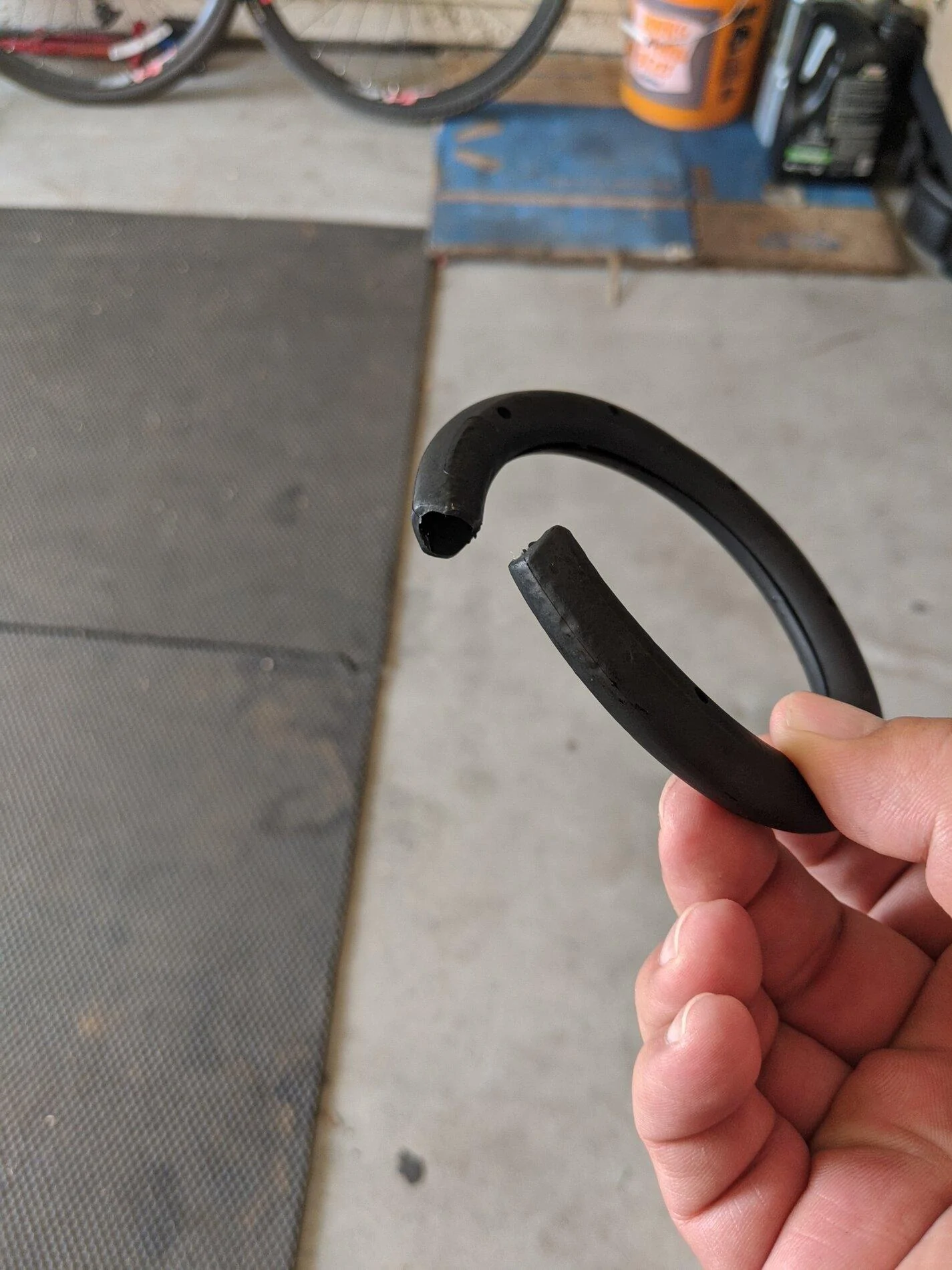

Update:
Received the sleeves from H&R. They sent me four individual sleeves, enough for one coil loop per spring. I captured photos of the coils to show the coil spacing with the car lowered to the ground and with it raised up on the jack. There is literally no spacing between the top 3 coils. I can see why other people have continued to have issues with the noise even after installing the sleeves. I didn't bother installing the sleeves after capturing these photos. You literally need enough sleeves to wrap around 3-4 coils on each spring to get rid of the metal to metal contact. Not sure what to do now other than try to send my photos to H&R and see what kind of feedback they can give.
First photo is with the car dropped. Second is with the car raised. Third is the individual sleeve. To be continued...

Update:
Thanks for sharing. Please report back when HR responds. I am still irritated with HR as when I talked to them, they said no one has ever called in with a Supra issue (this is after you posted the number here) and they wanted a bunch of install photos before sending out silencers. I have a broken shoulder so I cant jack the car up and take pics. Still getting noise in the rear and both fronts, WITH Tien spring silencers on. I am wondering if the entire upper half of each spring needs to be fully covered in the silencer.
Also a new issue is a very faint “loose” feeling in the steering wheel when the front tires engage with a speed bump. Very faint, almost feels like the steering wheel bolt which holds it on, is loose-but it is not. Wondering if it may be a loose strut center bolt even though I have had my springs installed twice now and told them to check this.
I am waiting for replacement suspension bolts now, then going back to stock as I have exhausted an incredible amount of time, money, and rage trying to fix the problem, so I think its time to cut my losses
